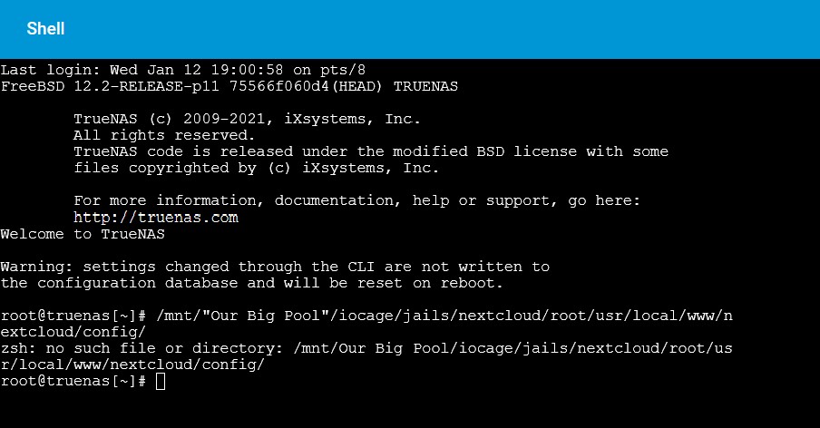

Hello,
Recently installed Nextcloud Version 23.0.0 on a new Truenas Mini 3.0 X+, running TrueNas 12.0 U7. I'm asking for help to determine how I can access the Config.php file to add the I.P. address of the Nextcloud server to the list of Trusted Domains. I've tried one of the methods identifed in the following community post:
I enabled the SSH service and entered the following text in the Shell CLI:
/mnt/"Our Big Pool"/iocage/jails/nextcloud/root/usr/local/www/nextcloud/config/
Received the error message: "no such file or directory...etc"
So I'm looking for help to determine where the Nextcloud Config.php file is located in TrueNas 12 U7 and also seeking advice on how to access and modify it using the Shell CLI and ee editor.
Thanks

I used the "find" command in the Shell CLI and got the location of config.php. The file location is as stated in the community post. CLI entries are case sensitive, good learning. Can anyone advise how to see the contents of the config.php file and how to edit the file contents?

Gave it try and got the following response "no such file or directory"

You need to be in the Nextcloud shell, not TrueNAS shell.
Go into the nextcloud jail and open the shell there, and try again.
