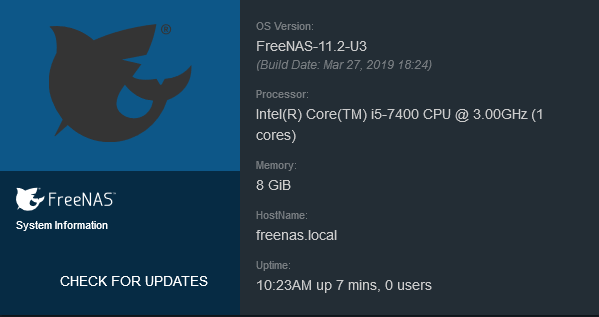

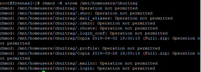

sistemasfh
Apr 12, 2019
3
can I change the permissions of user directories by console ??, ssh?

SweetAndLow
Sweet'NASty
Nov 6, 2013
6,421
Your dateset is probably a windows share dateset. What is the output of zfs get aclmode
