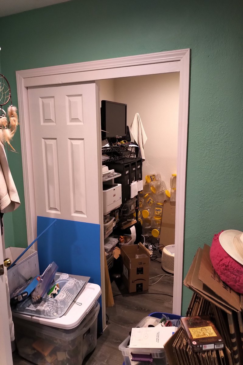

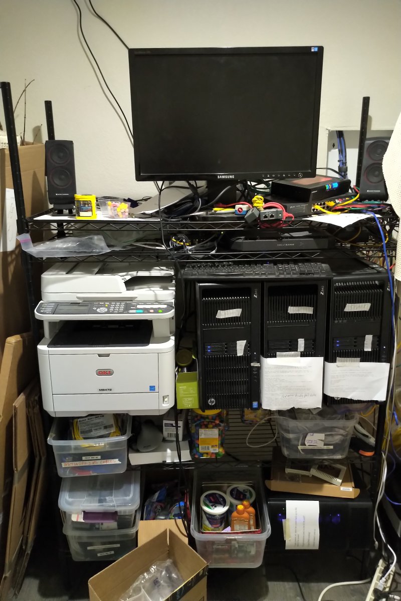

The door is always open; there is lots and lots of air exchange. The room is noticeably warmer than the adjacent room, but, like, only noticeably, not like a ton warmer.
In the second picture, the NAS is in the bottom right corner. This is inconvenient because the KVM cables don't reach that far, which is why it used to be to the left of the monitor, so now if something goes wrong and I need to see the console I have to power it off and move it.
I'm actually really surprised by the temp difference; the room only feels a few degrees warmer than the next room, I don't see how there can be that much range top-to-bottom. :shrug:

That minor temperature differance does seem to be making a big difference. All those systems packed in there just doesn't promote good cooling. You might add a small floor fan to blow air into the bottom of the closet which should force the hotter air out the top. Well try a few different angles to blow the air into the space and give it some time to stabilize to see how it reacts.
That looks like it's difficult to use the printer, lol.
Thanks for keeping us enaged with update info:
Question: is the XL+ in the bottom picture on its side? This would create a different thermal environment for the individual drives than if they were "stacked". Was the XL+ in the same orientation when it was "on the top shelf" as it is now?
Question: have you considered measuring the temperatures and, particularly the top to bottom temperature gradients, in the closet? It would be helpful to eliminate the "shrug".
Honestly I really thought everyone would be bored by now.
No, it was upright before, and yeah, that's probably relevant; I can't put it upright where it is now, though.
Yeah, I probably should.
