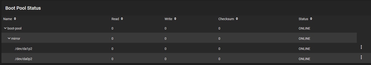

so, to make sure, this is how the setup should look if I want mirrors on the two boot drives

Samuel Tai
Apr 24, 2020
5,399
Yes, you've got it. Don't forget to add the 2nd drive to the BIOS boot order.

yeah I need to go fix my boot order generally. right now it takes forever looking for boot on IPv4 before it considers any drives and then goes through every drive in the system. plan on setting it to USB first, those two drives second then fail.
