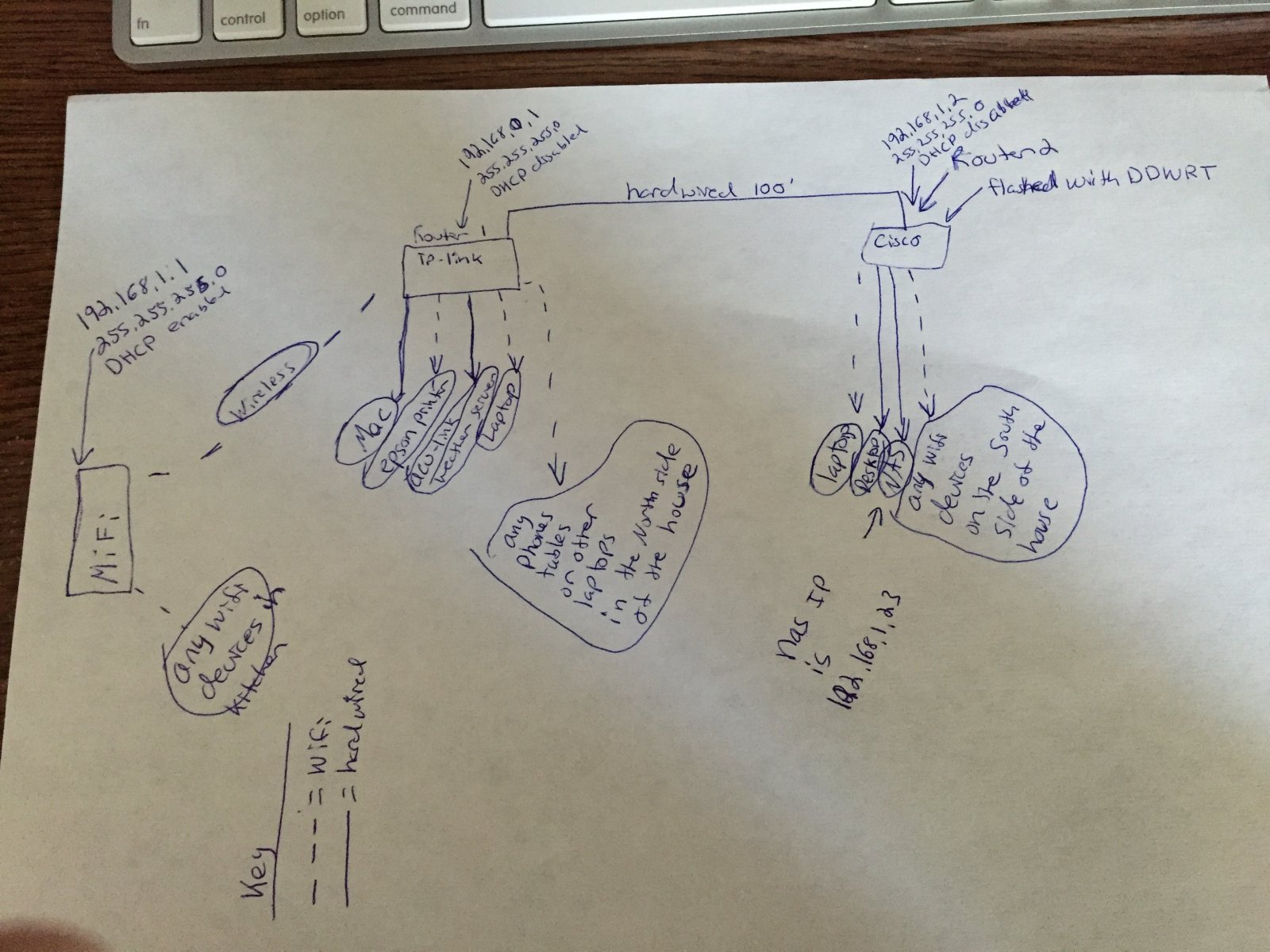

I have a Verizon MiFi we have to turn off daily that sends the signal to a main router, and then theirs a second router that's hard wired to the main router; which the nas server is connected to. My question is can I set the server to be accessible with out Internet on all of my computers?
I apologize for not answering your question properly. The answer is Yes. Internet connectivity has nothing to do with FreeNas functioning properly. In your case though since you have multiple routers on the network, only the computers connected to the 2nd router (the one that FreeNas is connected to), will be able to see the FreeNas. At least until you either flatten your network (change router #2 to a bridge), or port forward (or static route) through router #2.
Your post #1 and post #19 appear to be conflicting. One says wired, the other says wireless.
So to ask you a question. Can you please provide a network diagram, including physical connectivity, IP addressing (including IP space and subnet masks, as well as DHCP servers), and where the client devices are located? You can just draw it on a piece of paper and post a picture or use something like Visio.

Here you go! I hope this helps! If you have any questions about spelling ask me, I know my handwriting not the best!

That helps and confirmed my suspicions. Find the ip address of the laptop on the right and then using the laptop on the left try to ping that address. It will fail. That was what folks were trying to say, when they said it wasn't a FreeNas specific issue. For all intents and purposes, everything connected to the router on the left is considered "the internet" to the router on the right. The simplest thing you can do, is put the DDWRT router on the right into bridge mode which just extends the 192.168.0.XXX network to all the devices on the right side (they will all need to get new IP addresses).
