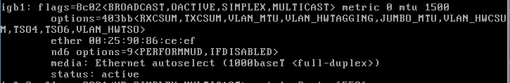

My file server vanished from the LAN, and when I reboot and watch the console (via IPMI) it says that no network interface is configured. I choose 1 from the menu, and the desired interface device igb1, and it asks me to confirm "reset". That's all it does: no choice of manual configuration or viewing of the information.
Choosing 9 (shell) and then ifconfig, I get (see screenshot attached).
Strange, it's not telling me the IP address. But, during bootup, it seems to have obtained one via DHCP just fine; I noticed an IP address go by that was in the expected subnet range. But I don't know how to review the boot log to go check in more detail.
The lights on the ports on both ends of the patch cord are on. It says "active" in ifconfig.
What am I missing?
Please help: I have no access to the file server at the moment.

First things first. Does it have an IP?
Two obvious ways to check this:
1) Go into your router, and look at the address assignments, see if you have one for the FreeNAS box
2) Download "fing" for your cell phone, run it on your wi-fi network, and if your FreeNAS has an IP, it'll tell you.
The client list does not show any entry (IPv4 or IPv6) for the FreeNAS.
How can I review the boot log, to see what it reported after initializing the network? I thought I saw a reasonable IP address mentioned as it went by quite fast.
