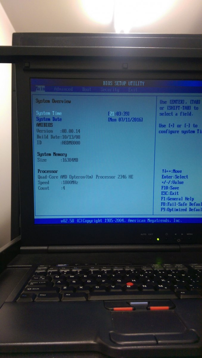

Hello everyone,
I am having a difficult time on installing FreeNAS on my server. I have a NAS from supermicro. The processor is an AMD opteron 2346. I have 16 gigs of RAM. The RAM is PC2-5300P ECC RAM. I have 2 USB ports in the back. 0 in the front and both are USB 2.0. Here is a link to the motherboard with all of the specs: http://www.supermicro.com/Aplus/motherboard/Opteron2000/MCP55/H8DME-2.cfm
I have tried multiple solutions. One being going in and changing the legacy USB to boot as a Hard Disk, remove quick boot, copy the command "debug.acpi.disabled="hostres"" into /boot/loader.conf, at the boot options type in the command "set debug.acpi.disabled="hostres"". All of the solutions did not work me. I recorded a video of the boot sequence for FreeNAS. I hope that someone has the patience to go through it all and determine what the issue is and if there is a potentioal fix.
I should note that this boot log was taken when the command "debug.acpi.disabled="hostres"" was copied into /boot/loader.conf

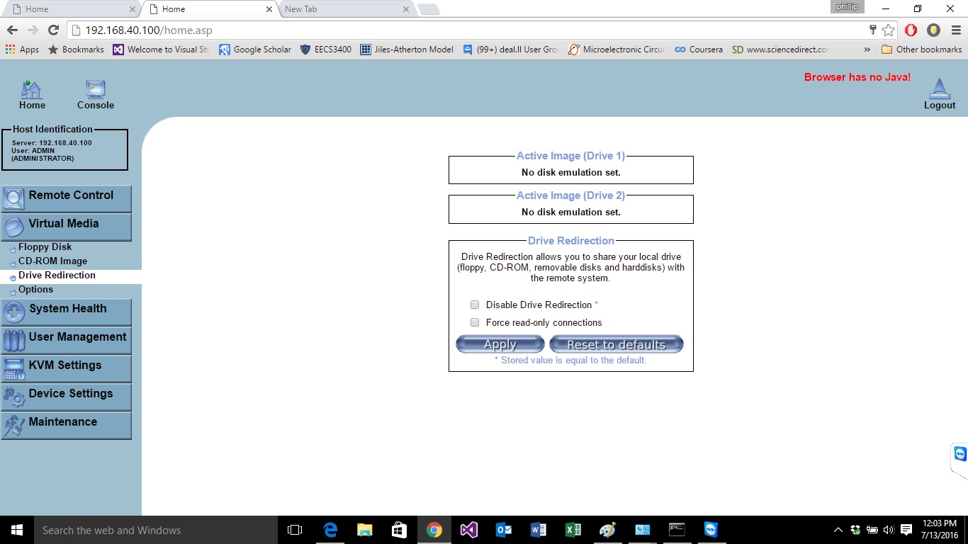

So I gained access to the IPMI and went to the drive redirection. Unfortunately, I do not see the option to be able to share my drive with the NAS. I have attached the picture for all to take a look at. Maybe I missed an option some where.
My only other option is to mount the image using windows share. Under there, I have 5 options, share host, share name, path to image, username (optional), and password (optional). For the share host, I placed my IP address (192.168.40.110). For reference, the IPMI IP address is 192.168.40.100. For the share name, I made up a name and called it iso. For the path to image, I have shared/freenas.iso.
I am assuming that when the IPMI connects, it is starting at C:/. My shared folder is in C:/. I setup the shared folder to allow anyone. However, I am still receiving the mount error. I am wondering if I have the path incorrect. I know that it creates a UNC path. I am not sure what I should place for the path to image or the share name.
Also, thank you everyone for taking the time to assist me. I appreciate it. This is the first time I am setting up a NAS. Thank you all for your time and patience with me.

I think the option you want to mount a virtual CD ISO is [Virtual Media] - [CD-Rom Image]. When asked for the path to the ISO, you should be able to browse to the folder on your PC and select the ISO.
*** Depending on the software, there may be a checkbox to make it use the ISO, but I can only reference my IPMI software from Dell so it may differ for you.
*** Also, in my IPMI software I have to leave the "Virtual Media" dialog opened otherwise it will discontinue to map/mount it.
When booting up the Server, you then should be able to select a boot option and tell it to use the "Virtual CD".
*** Should not need to setup any Share on your PC to do this.
