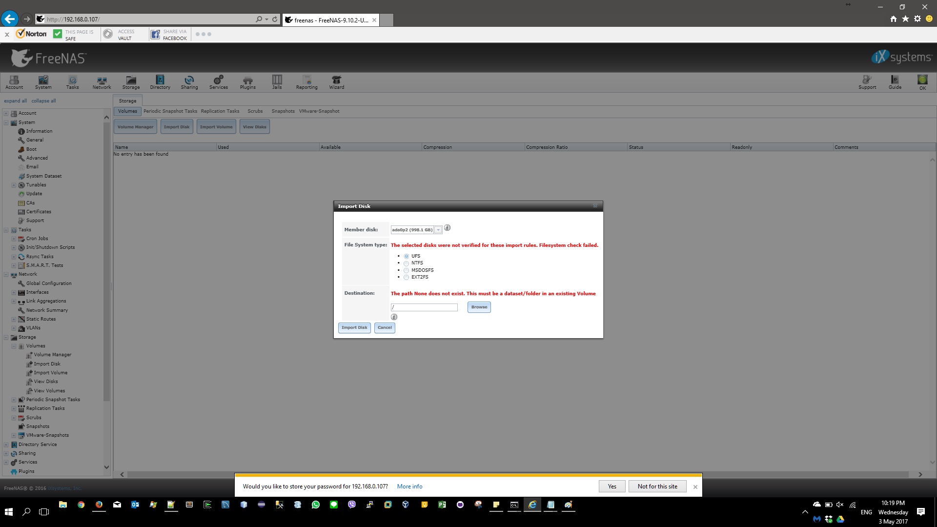

i managed to start a new system following the instruction you gave above.. but i dont know how to import the pool.. whenever i tried, i keep getting errors..

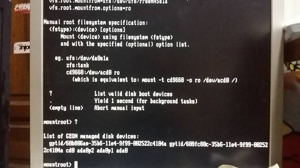

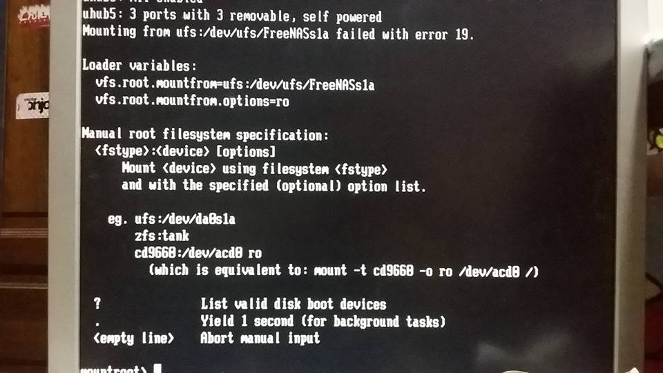

however, whenever i boot my old flashdrive.. i get stuck at this error.. i dont know how to proceed on. refer to nasa1.jpg and nasa2.jpg

Not Import Disk, Import Volume. Your old USB stick seems to be toast; that's not unusual (they're notoriously unreliable).

i tried the Import Volume option but i dont see any entries in the drop down box... its empty.. the system shows my drive is present and detected but i dont see anything related to the volume and data

i downloaded the FreeNAS 8.3.2-RELEASE-x86.iso and burn it in my CDR disc and boot it in my system .. windows recognise the disc size as 101MB
then i follow on screen instruction and i still end up at this prompt

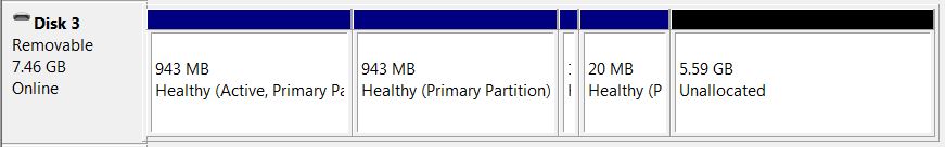

why is there so many partition inside my sandisk flashdrive after installing FreeNAS inside?
