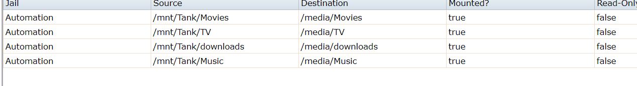

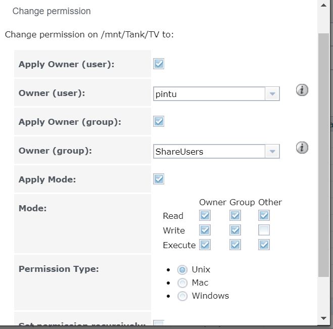

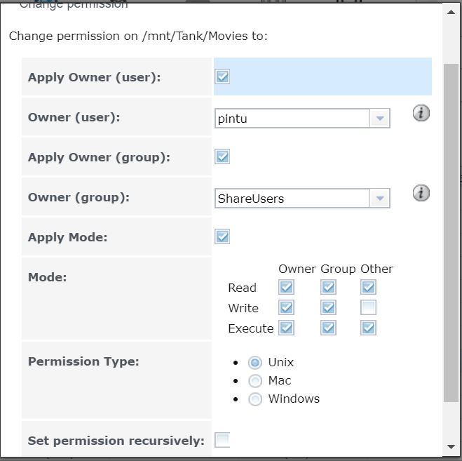

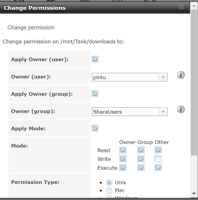

Hi everyone,
So I have installed Nzbget, Sonarr, Radarr, Subsonic, and Plex in 1 jail and I seem to have a problem with moving files after they are downloaded in Nzbget directory (/mnt/Tank/downloads) to their folders such as TV and Movies.
They unpack fine but don't every get moved into their correct locations.
I tried to change the write permissions for the jails by following the below guide (option #3):
https://forums.freenas.org/index.ph...plugins-write-permissions-to-your-data.27273/
But doesn't seem to work, also plex doesn't update any changes made to TV shows or Movies folders either.
I have attached my permission for movies and tv dataset as well as storage for the jail.
Any help to fix permissions for all plugins above would be great.
Thanks

Either give other write permissions or create the dataset group owner with the same gid in the jail.

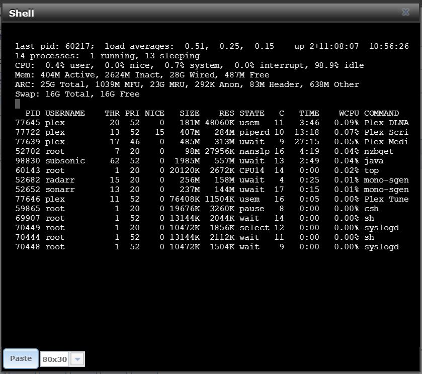

This sound like you are doing things correctly for the most part. Now we just need to find the one thing that is messed up.
To see the owner of a process you can use 'top' and it should show you the owner in the second column maybe.
pintu1228
Mar 16, 2015
61
Here is what I get when I type in 'top', see attachment.

So I am running into another issue, what exactly source and destination do I use for Nzbget, sonarr, and radarr.
When I download a movie via Radarr, it downloads fine in nzbget but files are not put into the /media/Movies directory.
Can anyone provide an example on how to use the source/destination storage for all three of these plugins so they work correctly?? Also do I have to run these plugins as root:wheel or another user?
Source is the dataset in freenas you want to use. Destination is the path inside the jail you want that dataset to show up. So all your applications should have the destination configured as their download location or library location.
To get things like sonar to work make sure your destination path is the same string as the path the downloader uses.
