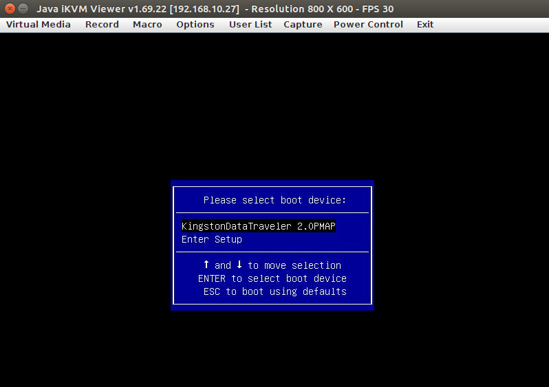

Yes the installation is done I changed the BIOS by using F11, I set it to the USB drive.
That's a one-time boot. To set this permanently you'll have to get into the BIOS using the delete key instead of F11.

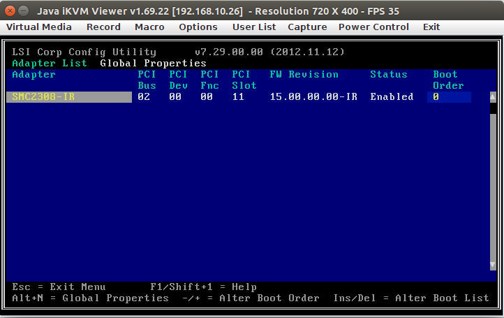

Next problem I face: WARNING: Firmware version 15 does not match driver version 16 for /dev/mps0
Update the LSI SAS 2308's firmware to P16 IT mode.

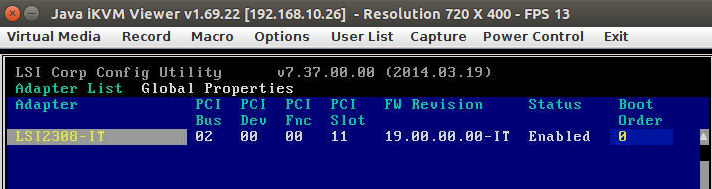

Is anybody able to help me and let me know if below is correct?
demon
Dec 6, 2014
117
You really should stick with the phase 16 firmware on your SAS adapter. The drivers in FreeNAS 9.2 and 9.3 are phase 16 (version 16.0.0.0-fbsd), and matching the versions is the only supported setup. Phase 19 is way too new.
