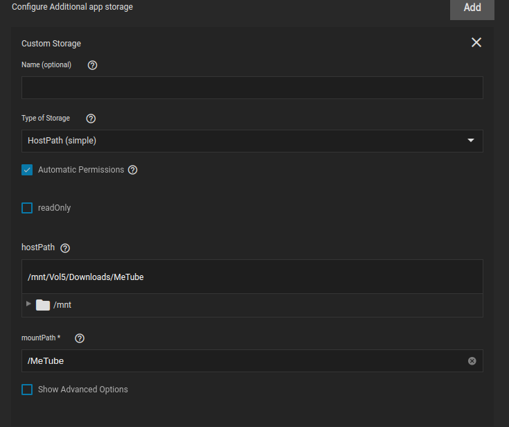

The downloaded files for Metube are downloaded to /home/Downloads which is the typical location of any Linux install when downloading from a web browser. In the Link i added it says
"Certain values can be set via environment variables, using the -e parameter on the docker command line, or the environment: section in docker-compose."
DOWNLOAD_DIR: path to where the downloads will be saved. Defaults to /downloads in the docker image, and . otherwise.
I have done the following in the photo to add a Dataset location to use for the downloads instead of the default /home/downloads which is what MeTube uses, the issue i am having is how to change the default location, i found a config file but it's read only and the information in the link which describes how to set your own download location instead of using the default which i am trying to do has gone right over my head as i'm new to Docker and learning how to set stuff up.

Are you using Truecharts version of MeTube? If not, how are you launching the application?
If you are launching it yourself, you can use the env var im assuming, but if not you should not have to use the env var as the storage under the Truecharts app already has an option to change the downloaded path. (if the description is correct).

I am using the Truecharts version and added the mount path i want to use as the new download location and it still downloads to /home/downloads. Unless i am totally missing something right before my eyes adding a mount point to storage and persistence doesn't change a thing.
Yes, you are missing something.
You are attempting to add additional storage. When all you SHOULD have to do is EDIT the existing storage.
1. Go to your edit configuration for MeTube
2. Scroll down to Storage and Persistence
3. Look at my photo
a. Under App Download Storage
b. Look for Type of Storage
c. Change it to Hostpath (simple)
d. Under Hostpath, enter the path you wish to save your files.
IF that does not work, THEN you can try adding additonal storage, and setting the download storage with an environment variable. It looks like right now though, that it is un-needed.
I highlighted all of the stuff to look for under Storage and Persistance in red, in my photo I posted earlier.

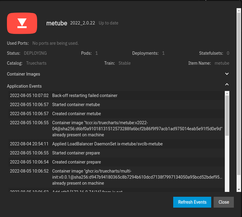

I have followed the steps on the photo you added and all i get is the error in the photo if i use the Hostpath (Simple) and add the location i want to download and then save and it will sit at deploying and do nothing else. How would i set the download storage using an environment variable?

Method 1.
Edit the storage to hostpath.. like ive been saying works, I deployed the app as a sanity check, and it did download to the hostpath I specified.
If it didnt work for you, you have to be doing something wrong. Delete the app and retry or something. Also make sure your dataset permissions for the hostpath you are choosing allows apps:apps to access it.

Thank you for the response, the issue was resolved
i removed the app, reinstalled, hostpath (simple) was pointed towards /Vol5/Downloads/MeTube but it still failed on the container till i realised i had not added the user apps to the Dataset and once i did it downloaded fine.
