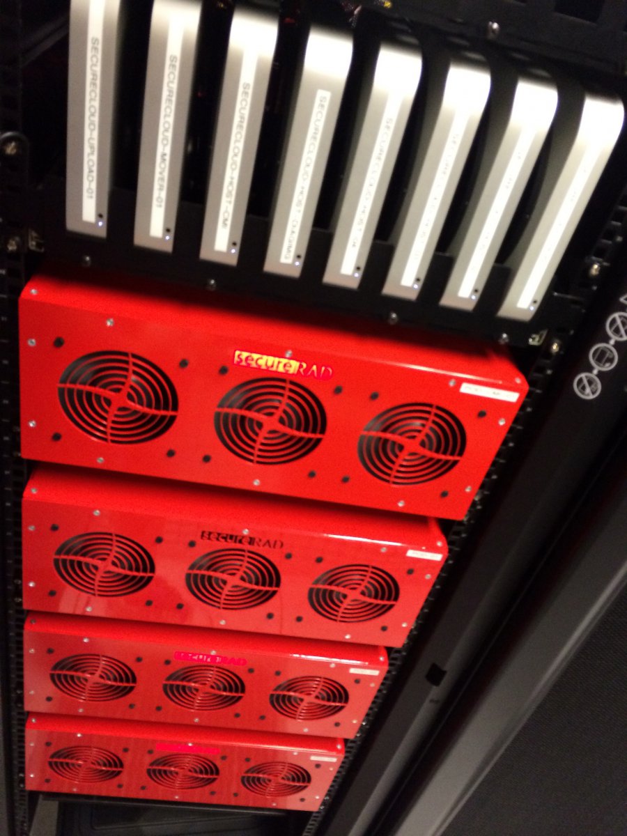

RichR
Oct 20, 2011
77
Kind of (45drive.com). V1 we bought the enclosures from them then customized the rest (before 45drives.com even existed), but I made subsequent design revisions, now on V4. But we won't use them anymore. The density is nice, but frankly unneccesary and at times a pita.... having to shut down a production machine to get inside, for whatever reason, isn't fun, nor worth the stress.
Regarding the boot ROM, would you mind explaining a little more? Not following you when you say "can't insert itself." I thought if disabling the boot option from the LSI bios would be the best approach - apparently the MB won't see the drives if I do either. Ideally, I'd like to have the option to load the LSI BIOS if needed, but not have the drives show up on the BIOS of the motherboard. If they do show up as boot options in the MB, I can't choose the SSD.
Attached is one of 3 racks of these
