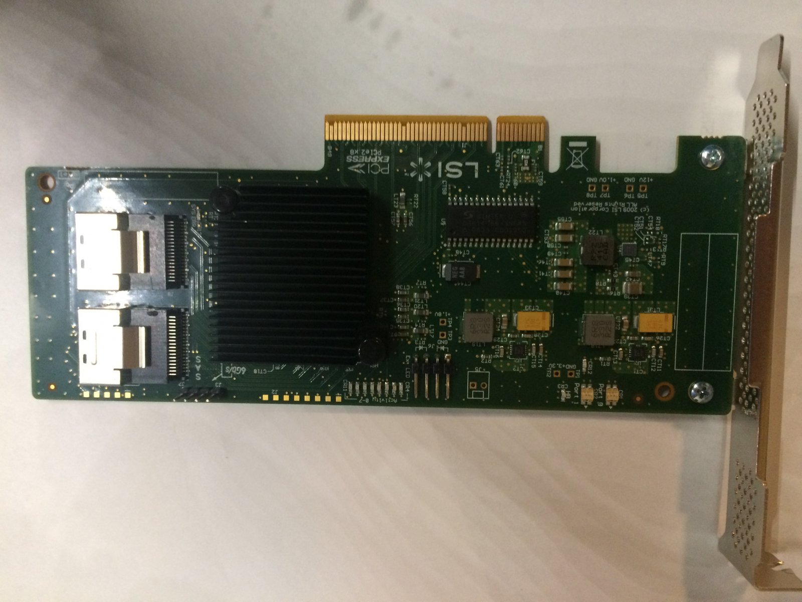

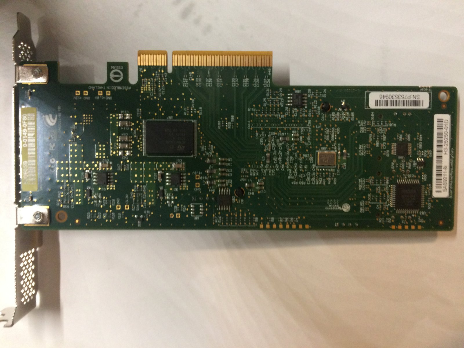

I pulled the card and took a few pictures. I do have it connected via a ribbon cable that came with the case. I've never had an issue with one before, but could be a failure point. I wouldn't expect something so basic to be faulty though. I'm going to put the card back and will report with what the bios says.

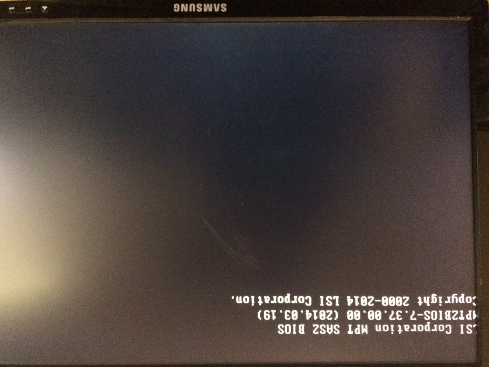

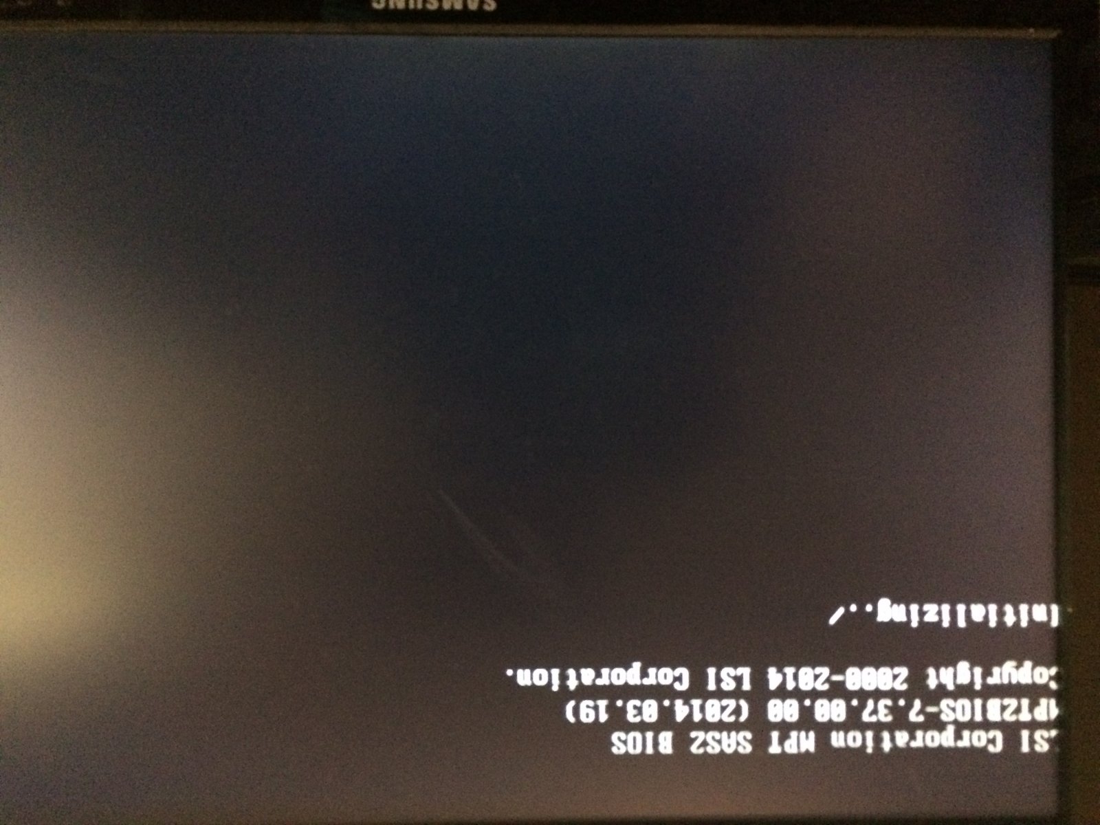

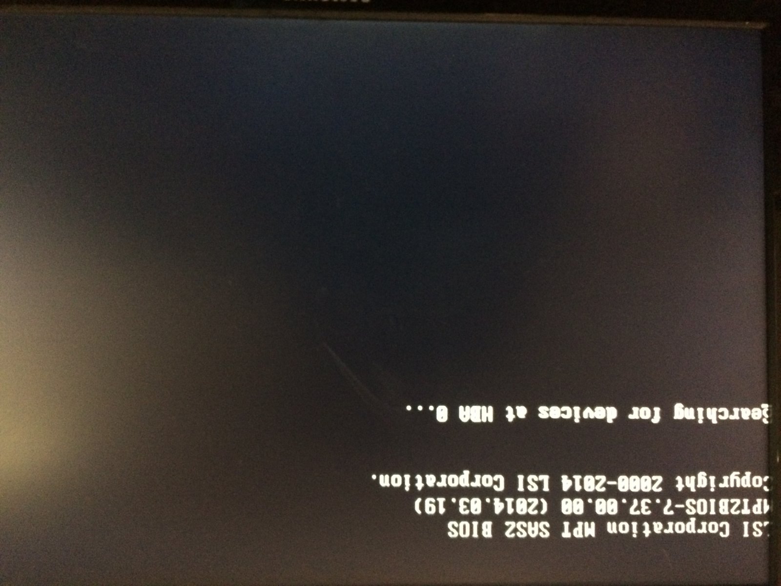

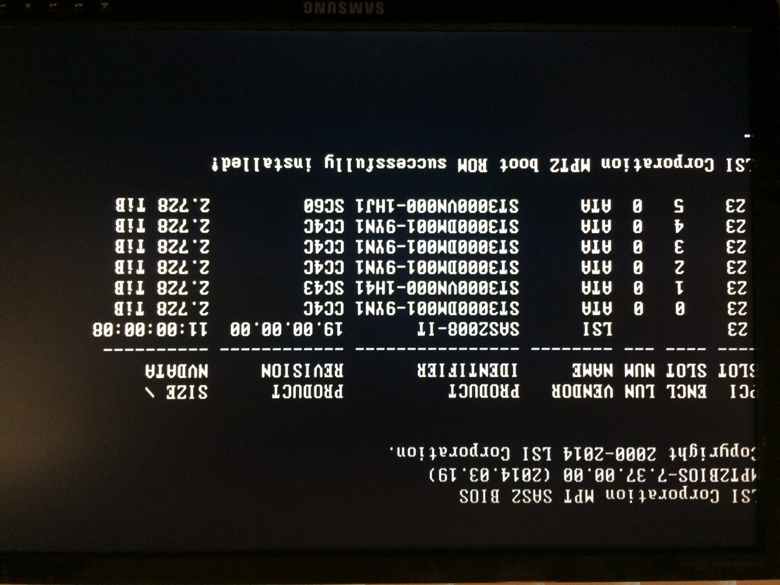

It's definitely seated well. I made sure of that when I put the card back in. I have seen the drives appear. I took pictures of the boot process. It takes around 10 minutes for the BIOS process to complete, around 10 minutes. Is that normal?
First, it shows the copyright information about a minute later it says initializing. After another 2-3 minutes it says searching for devices on HBA0. Finally about 5 minutes after that it shows the drives for a few seconds and then tried to boot to one of them. But of course it can't and I just get the message that says this is a ZFS data disk. System halted.
Nothing screams fake, however:
These are very often flaky.
No
Need to check your BIOS and set the proper Boot Device order. Assuming you have FreeNAS installed on a USB, you would set that as the first device.

Agree with @Mirfster that 10 minutes is way too long for the HBA to initialize, and you need to configure your system's BIOS settings so that it boots from the USB flash drive.
Your photographs also show two things:
  1. You're running the older P19 version firmware; you need to update this to P20.
  2. You're running 4 of the Seagate ST3000DM001 hard drives; these are notorious for failing and you need to test them thoroughly before committing any important data to them. In fact, I would go so far as to agree with the good @DrKK and suggest you replace them immediately. :smile:
