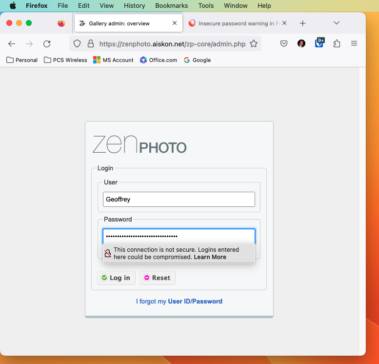

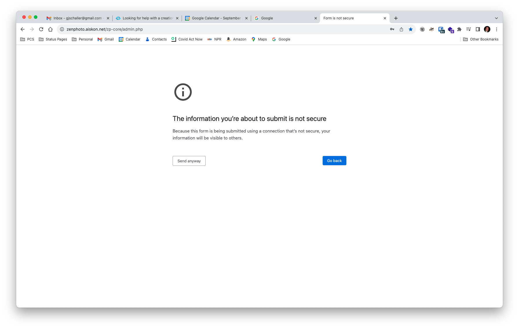

OK, I was able to reproduce the issue. It's ONLY on the Login form, it seems. Here's my setup:
Public Internet => Router => Apache Proxy Server in DMZ of Router => Jails (ZenPhoto, Nextcloud, etc.) behind the proxy server
Apache is configured to proxy to the Jail's IP: http://10.0.0.248
Jail is created with NO_CERT
Most form submissions seem to work fine, but when I try to log into https://zenphoto.aiskon.net/zp-core/admin.php both FireFox and Chrome warn me that the form is not secure. Images attached.

According to the docs and zenphoto forums, it appears it is a problem with zenphoto itself being a bit slow in responding to the requests. Or that the protocol is set to http
I am having the same issue. You could try with a standalone, dns, or even selfsigned cert, and setting the protocol to https within zenphoto security settings.
That's where I am running into the issue. Standalone won't work (I think) as it's behind a Proxy. DNS, I need help figuring out how to configure it to work with Namecheap. I can try self-signed, but would prefer to get DNS working if possible.
I did try to follow the instructions to get the Namecheap plugin to work, but it didn't work out. If this needs to be a new thread, I can start a new thread.
