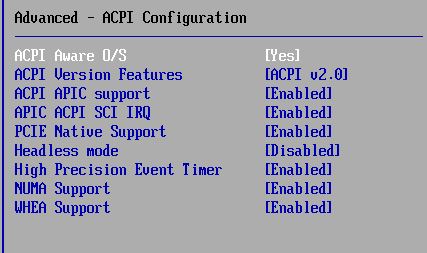

As a update. My reboots seem to now be persisting even with the SuperMicro AOC-STGN-I2S card removed from the server. Sometimes it just takes longer to reboot. I had over 12 hours on this last hammering before it finally reboot at about 12:20pm my time which gave me another NMI error...
2 01/16/2016 12:23:23 OEM Critical Interrupt Software NMI @ BUS:0 /Dev:1 /Func:0 - Asserted
lspci says that bus 0, device 1 is....
00:01.0 PCI bridge: Intel Corporation 5520/5500/X58 I/O Hub PCI Express Root Port 1 (rev 22)
That is with ACPI v2.0 enabled instead of 3.
I have a SuperMicro Tech working with me on this too. He loaded up a motherboard with FreeNAS and got the same error on startup.
Anyone have any ideas as to what else I should try?
