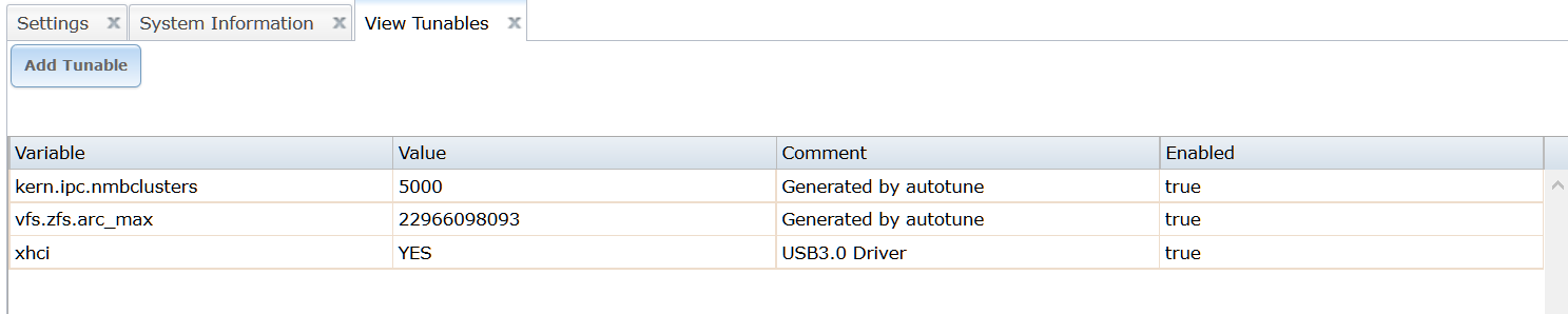

Just put my FreeNAS server into a new case which has USB3.0 front ports. My motherboard doesn't (SuperMicro X9SCM-F) so I bought a cheap USB3.0 pcie card.
After reboot, I had to run kldload xhci for it to start working, so I followed the instructions on adding it as a tunable so it would be available on startup, but I obviously did it wrong, because it didn't load.
So, any hints on how to get xhci to autoload on startup?

I removed it when it didn't work, but I'll just add it again. Here's what I've added.

After the reboot (with this tunable), did it show in kldstat? If not, there should be a related error in /var/log/messages.

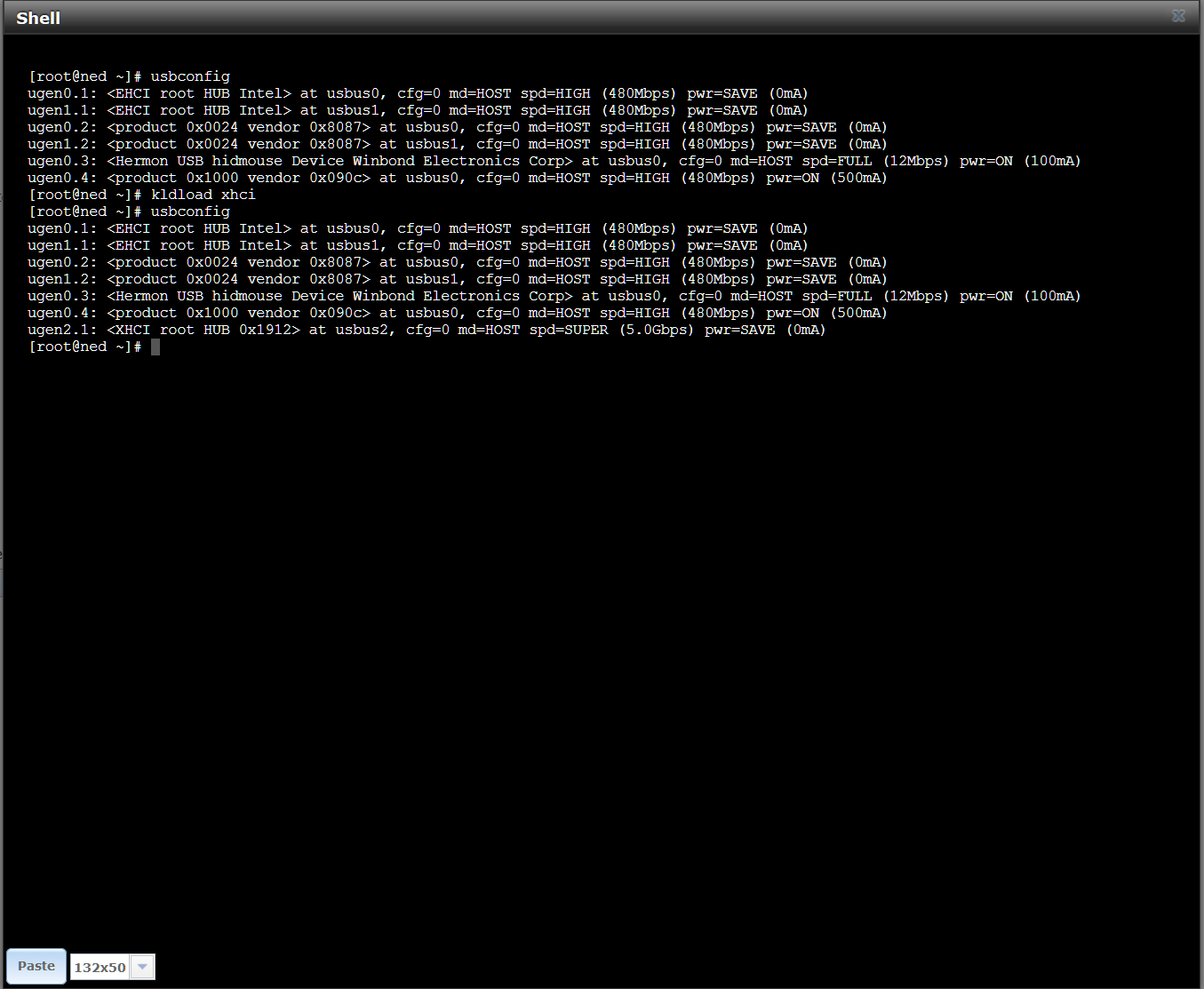

Just rebooted with tunable again, and no loading. On bootup on the console it says "Loading Kernel Modules:" but then has nothing after it. Here's the output of various commands. Maybe I have top put xhci.ko as the name?

[root@ned ~]# usbconfig
ugen0.1: <EHCI root HUB Intel> at usbus0, cfg=0 md=HOST spd=HIGH (480Mbps) pwr=SAVE (0mA)
ugen1.1: <EHCI root HUB Intel> at usbus1, cfg=0 md=HOST spd=HIGH (480Mbps) pwr=SAVE (0mA)
ugen0.2: <product 0x0024 vendor 0x8087> at usbus0, cfg=0 md=HOST spd=HIGH (480Mbps) pwr=SAVE (0mA)
ugen1.2: <product 0x0024 vendor 0x8087> at usbus1, cfg=0 md=HOST spd=HIGH (480Mbps) pwr=SAVE (0mA)
ugen0.3: <Hermon USB hidmouse Device Winbond Electronics Corp> at usbus0, cfg=0 md=HOST spd=FULL (12Mbps) pwr=ON (100mA)
ugen0.4: <product 0x1000 vendor 0x090c> at usbus0, cfg=0 md=HOST spd=HIGH (480Mbps) pwr=ON (500mA)
[root@ned ~]# kldload xhci
[root@ned ~]# kldstat
Id Refs Address Size Name
1 68 0xffffffff80200000 1468380 kernel
2 1 0xffffffff81812000 4845 geom_stripe.ko
3 1 0xffffffff81817000 10489 geom_raid3.ko
4 1 0xffffffff81828000 efdd geom_raid5.ko
5 1 0xffffffff81837000 5806 geom_gate.ko
6 1 0xffffffff8183d000 49bd geom_multipath.ko
7 1 0xffffffff81842000 15ff44 zfs.ko
8 14 0xffffffff819a2000 5701 opensolaris.ko
9 1 0xffffffff819a8000 b56 dtraceall.ko
10 1 0xffffffff819a9000 4ea3 profile.ko
11 3 0xffffffff819ae000 3569 cyclic.ko
12 11 0xffffffff819b2000 3433a dtrace.ko
13 1 0xffffffff819e7000 fb24 systrace_freebsd32.ko
14 1 0xffffffff819f7000 1098d systrace.ko
15 1 0xffffffff81a08000 4bca sdt.ko
16 1 0xffffffff81a0d000 48f5 lockstat.ko
17 1 0xffffffff81a12000 a9cc fasttrap.ko
18 1 0xffffffff81a1d000 6663 fbt.ko
19 1 0xffffffff81a24000 557d dtnfscl.ko
20 1 0xffffffff81a2a000 4585 dtmalloc.ko
21 1 0xffffffff81a2f000 4488 dtio.ko
22 1 0xffffffff81a34000 30fc5 if_cxgbe.ko
23 2 0xffffffff81a65000 2bb1 vboxnetflt.ko
24 2 0xffffffff81a68000 361ff vboxdrv.ko
25 1 0xffffffff81a9f000 447f ng_ether.ko
26 1 0xffffffff81aa4000 400a vboxnetadp.ko
27 1 0xffffffff81aa9000 b69e xhci.ko
ugen2.1: <XHCI root HUB 0x1912> at usbus2, cfg=0 md=HOST spd=SUPER (5.0Gbps) pwr=SAVE (0mA)

This is all true. However, it loads manually with kldload but not from the GUI. Depending upon the version and the results of adding .ko in the GUI, it may be a doc or a software bug.
