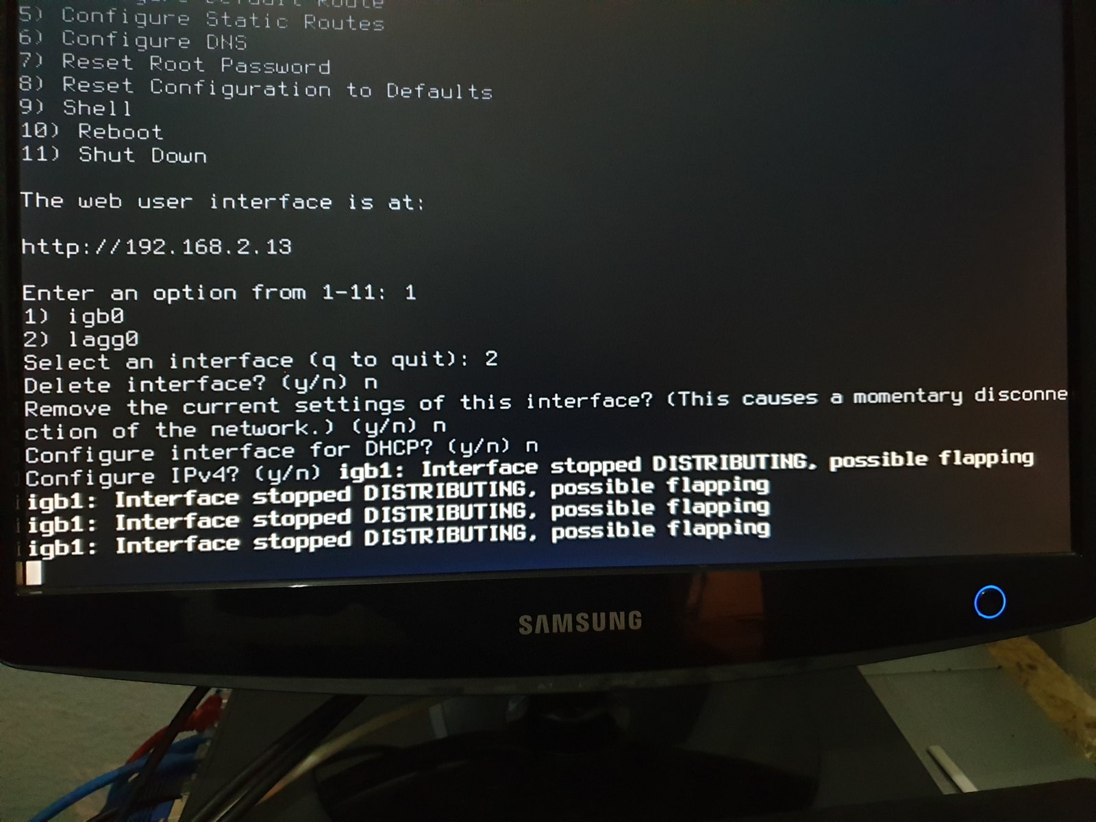

And also I tried creating straight from that FNAS startup menu, I delete all interfaces, create LAG, setup IP and mask, but it starts giving these errors.
Looking around it seems like it requires active LACP and my switch don't have the option to select that. Is that the case and if so... what solutions are there?

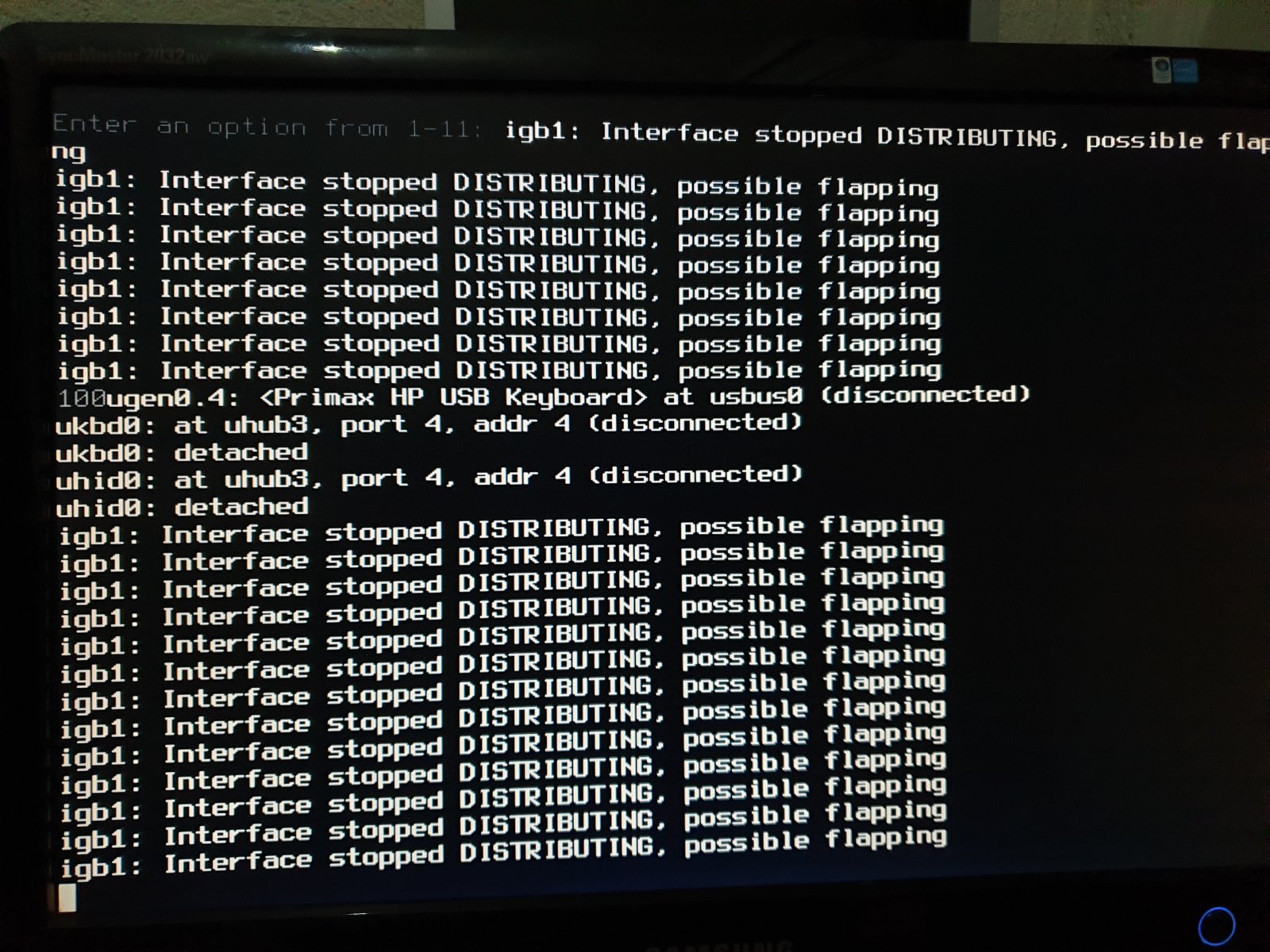

Attached screenshot of what happens when I setup ipv4.

And back to square one.
For some reason it just stopped working. And again no way to set it up properly. It should be straight forward but it proves to be unbeatable.

As soon as I start working with LACP everything goes to mess.
I can't even setup aggregation in GUI because it gives me error:
The network 192.165.100.0/24 is already in use by another interface.
Whatever IP I use it is same error even though there are no other interfaces using those IPs at all. Now it is completely isolated system, switch, NAS and my computer.
Will use shell only for any changes but why does it say that when it is not true. Maybe that is part of the problem?
Anyway process is simple, I go to shell, remove all interfaces aggregation and network, reset all configuration. Setup Link aggregation, choose both NIC and then setup interface IP and mask.
And nothing. NAS cant even ping switch.
