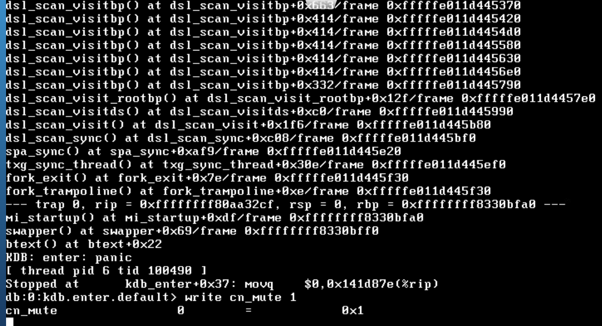

The above configuration was running Great with an FreeNAS installation. Then i discoverd, that the VM is in an running reset state, which is triggerd out of an kernel Panic. After some research, i reinstallt TrueNAS 13.0 U3. The running reste was gone. I imported the ZFS-Pool resting on both HDDs. The Shell says, i shall run an scurb, because it has lost the last 5 Secounds of data, but the data is till this point consistent.
But after the Pool was online again, the running reset is back again. I disconnected the pool drives harnesses, and the reset disappeard again.
Any ideas, how i can dig into the problem? I think, as soon the scrubbing is done, the running reset should also dissapear, but how can i finish the scrubbing, when the kernel boots again and again?

I imported the pool again, and suspended the scrub prozess right behind --> no problem. no kernel panic. After Start it again, kernel panic. But now i managed, to brows through the log files. The fault is triggered by an Inter divide in kernel mode, running scrub.
Dec 12 01:03:26 truenas 1 2022-12-12T01:03:26.936825-08:00 truenas.local smartd1134 - - Configuration file /usr/local/etc/smartd.conf parsed but has no entries Dec 12 01:03:27 truenas 1 2022-12-12T01:03:27.128188-08:00 truenas.local daemon1118 - - 2022-12-12 01:03:27,121:wsdd WARNING(pid 1119): no interface given, using all interfaces Dec 12 01:03:32 truenas 1 2022-12-12T01:03:32.323637-08:00 truenas.local daemon1281 - - 2022-12-12 01:03:32,322:wsdd WARNING(pid 1282): no interface given, using all interfaces Dec 12 01:27:53 truenas syslog-ng[990]: syslog-ng starting up; version='3.35.1' Dec 12 01:27:53 truenas Fatal trap 18: integer divide fault while in kernel mode Dec 12 01:27:53 truenas cpuid = 0; apic id = 00 Dec 12 01:27:53 truenas instruction pointer = 0x20:0xffffffff828f2795 Dec 12 01:27:53 truenas stack pointer = 0x28:0xfffffe0111399050 Dec 12 01:27:53 truenas frame pointer = 0x28:0xfffffe0111399060 Dec 12 01:27:53 truenas code segment = base 0x0, limit 0xfffff, type0x1b Dec 12 01:27:53 truenas = DPL 0, pres 1, long 1, def32 0, gran 1 Dec 12 01:27:53 truenas processor eflags = interrupt enabled, resume, IOPL = 0 Dec 12 01:27:53 truenas current process = 6 (txg_thread_enter) Dec 12 01:27:53 truenas trap number = 18 Dec 12 01:27:53 truenas panic: integer divide fault Dec 12 01:27:53 truenas cpuid = 0 Dec 12 01:27:53 truenas time = 1670837208 Dec 12 01:27:53 truenas KDB: stack backtrace: Dec 12 01:27:53 truenas db_trace_self_wrapper() at db_trace_self_wrapper+0x2b/frame 0xfffffe0111398e70 Dec 12 01:27:53 truenas vpanic() at vpanic+0x17f/frame 0xfffffe0111398ec0 Dec 12 01:27:53 truenas panic() at panic+0x43/frame 0xfffffe0111398f20 Dec 12 01:27:53 truenas trap_fatal() at trap_fatal+0x385/frame 0xfffffe0111398f80 Dec 12 01:27:53 truenas calltrap() at calltrap+0x8/frame 0xfffffe0111398f80 Dec 12 01:27:53 truenas --- trap 0x12, rip = 0xffffffff828f2795, rsp = 0xfffffe0111399050, rbp = 0xfffffe0111399060 --- Dec 12 01:27:53 truenas ext_size_add() at ext_size_add+0x35/frame 0xfffffe0111399060 Dec 12 01:27:53 truenas range_tree_add_impl() at range_tree_add_impl+0x12f5/frame 0xfffffe0111399150 Dec 12 01:27:53 truenas scan_io_queue_insert_impl() at scan_io_queue_insert_impl+0xa7/frame 0xfffffe0111399190 Dec 12 01:27:53 truenas dsl_scan_scrub_cb() at dsl_scan_scrub_cb+0x6c4/frame 0xfffffe0111399210 Dec 12 01:27:53 truenas dsl_scan_visitbp() at dsl_scan_visitbp+0x4b0/frame 0xfffffe01113992c0 Dec 12 01:27:53 truenas dsl_scan_visitbp() at dsl_scan_visitbp+0x663/frame 0xfffffe0111399370 Dec 12 01:27:53 truenas dsl_scan_visitbp() at dsl_scan_visitbp+0x414/frame 0xfffffe0111399420 Dec 12 01:27:53 truenas dsl_scan_visitbp() at dsl_scan_visitbp+0x414/frame 0xfffffe01113994d0 Dec 12 01:27:53 truenas dsl_scan_visitbp() at dsl_scan_visitbp+0x414/frame 0xfffffe0111399580 Dec 12 01:27:53 truenas dsl_scan_visitbp() at dsl_scan_visitbp+0x414/frame 0xfffffe0111399630 Dec 12 01:27:53 truenas dsl_scan_visitbp() at dsl_scan_visitbp+0x414/frame 0xfffffe01113996e0 Dec 12 01:27:53 truenas dsl_scan_visitbp() at dsl_scan_visitbp+0x332/frame 0xfffffe0111399790 Dec 12 01:27:53 truenas dsl_scan_visit_rootbp() at dsl_scan_visit_rootbp+0x12f/frame 0xfffffe01113997e0 Dec 12 01:27:53 truenas dsl_scan_visitds() at dsl_scan_visitds+0xc0/frame 0xfffffe0111399990 Dec 12 01:27:53 truenas dsl_scan_visit() at dsl_scan_visit+0x1f6/frame 0xfffffe0111399b80 Dec 12 01:27:53 truenas dsl_scan_sync() at dsl_scan_sync+0xc08/frame 0xfffffe0111399bf0 Dec 12 01:27:53 truenas spa_sync() at spa_sync+0xaf9/frame 0xfffffe0111399e20 Dec 12 01:27:53 truenas txg_sync_thread() at txg_sync_thread+0x30e/frame 0xfffffe0111399ef0 Dec 12 01:27:53 truenas fork_exit() at fork_exit+0x7e/frame 0xfffffe0111399f30 Dec 12 01:27:53 truenas fork_trampoline() at fork_trampoline+0xe/frame 0xfffffe0111399f30 Dec 12 01:27:53 truenas --- trap 0, rip = 0xffffffff80aa32cf, rsp = 0, rbp = 0xffffffff832fffa0 --- Dec 12 01:27:53 truenas mi_startup() at mi_startup+0xdf/frame 0xffffffff832fffa0 Dec 12 01:27:53 truenas swapper() at swapper+0x69/frame 0xffffffff832ffff0 Dec 12 01:27:53 truenas btext() at btext+0x22 Dec 12 01:27:53 truenas KDB: enter: panic Dec 12 01:27:53 truenas ---<<BOOT>>---

Corruptions in hypervisor environments are unfortunately somewhat common, because hypervisors have a chilling tendency to reorder data which causes ZFS to lose its marbles. This is why we have a very specific, very clear set of guidelines for virtualizing TrueNAS.
I'm going to make a guess that at least one of the following things is true:
1) These disks are not directly attached to the TrueNAS VM using PCIe passthru and an LSI HBA,
2) These are vmdk disks that are situated on a VMFS datastore that lacks controller level redundancy (i.e. JBOD or RAID0),
3) The controller that runs these disks is a RAID controller with write caching
The pool is probably toast. Your best bet is to mount it read-only, and copy all the data that you can off of it. There is a good chance that it may crash during this process. That is what backups are for.
