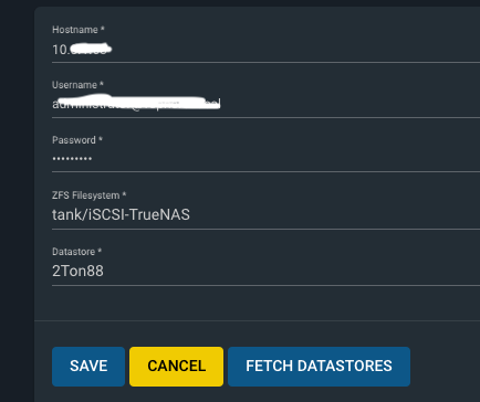

Running FreeNAS 11.3u5. I have a 3 Server ESXi cluster all connected to a iSCSI share. All the VMs are located on the iSCSI share.
I can of course take a snapshot in VCenter, but when I tried to take a VM SNAPSHOT in FreeNAS it wants to snapshot the entire ESXi DataStore (shows local drives and iSCSI drive) share.
How to take an individual VM snapshot from FreeNAS? What happens if I click SAVE (below)? I do NOT want a snapshot of this entire drive.
9,700
Looks like you need to re-engineer your setup to solve your request.
You need one ZVOL per VM if you're going to snapshot individual VMs.
If you want to continue as you are, you will get a snapshot covering the entire zvol for each of your machine snapshots (remembering that this doesn't actually represent a lot more data if nothing else is changing, so maybe that's OK), but in that snapshot, only the VM being targeted will have been forced to coalesce, so the references to all the other virtual disks will be untrustworthy.

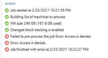

ok, Installed VEEAM, added storage , have access to VMs and Backup storage but the jobs die with pre-job error, I opened a ticket with Veeam.
HONESTLY all this b*llshit, WHY DON'T I just take a periodic CLONE of the VM and put it on secondary storage, even without doing snapshots to save space this would be a totally workable solution. Anyone got a script that works with VMWARE and FreeNAS!
