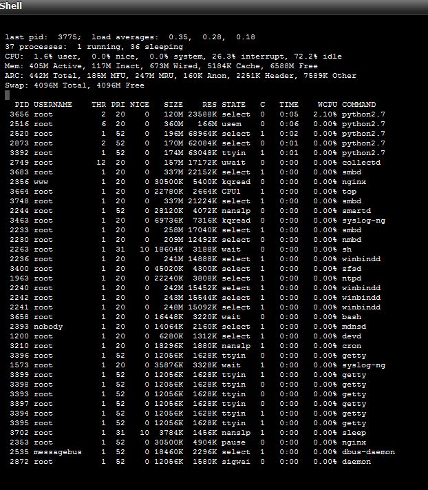

How can I find out what makes interrupt to keep cpu busy? TIA

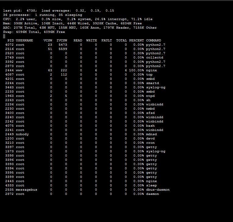

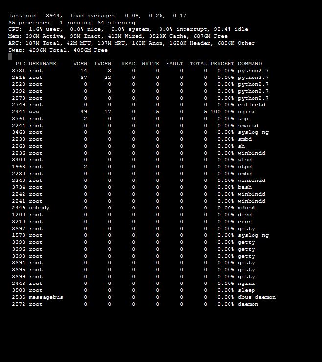

I learned that if only one client is attached to FreeNas, all is ok. As soon as a second client is attached the Interrupt cpu usage goes higher. I have attached screen shots of "top -mio" for normal and high cpu usage. Can anybody suggest why this is happening?
