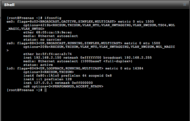

sjoerdbird
Sep 3, 2013
10
This is the output of ifconfig: see image

cyberjock
Inactive Account
Mar 25, 2012
19,525
Sure does look like its detected.. see em0? But it says no carrier which means there's no cable attached to it. Usually that's user error. ;)
