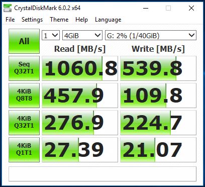

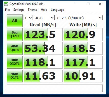

Bad card it appears. Swapped between one of the ESX boxes and FreeNas card show up in FreeNAS now, and doesn't in ESX...figures I would put the two good ones into ESX and the bad one in FreeNAS causing me to think I didn't do something right...lol. I am sure quite a bit of this is due to caching, but I would say the bandwidth is there. Right now I am just doing direct connect with 1x10Gb link for ISCSI. Before I had 2x1GB links on a Distributed switch in Vmware. This is from inside a Windows 2016VM. The OS drive is on flash but the G drive I am testing is on the ISCSI lun on my Freenas its only a 2 drive Mirror with 120GB Log so this looks about right if I removed caching from the equation. I will RMA the bad NIC for my other ESX and should be good to go. Hopefully I will find a 10Gb switch a little later when the funds appear and then run fiber to my desktop upstairs for 10Gb here.
