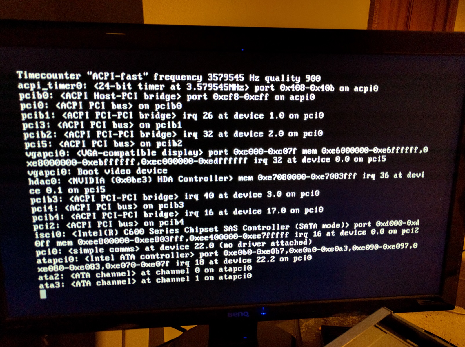

This very well may be a hardware issue / compatibility issue, but I figured I would ask here. I have an old HP workstation z420 that I wanted to install freenas on. Xeon 6 core cpu 16 gigs of ECC ram. No matter what method of installation I choose, no matter what version I use, I the installer gets stuck at the same spot:
ata3: <ATA channel> at channel 1 on atapci0
This happens no matter what sata port I plug my HD into. I don't even need to use the onboard sata ports as I purchased a HBA from LSI, but for whatever reason there is no way to turn off sata/sas on this hp bios. It happens even if I plug no hard drives in.
Anything you guys think I should try? If my screenshot is not enough to go off let me know and I'll get the dump or whatever you guys call it.

At first glance it looks like a machine that should be fine with FreeNAS, but the SATA controller specs are vague. Of course, that might not be the cause of the boot failure.
Did you checksum the installer download?
Do you have another machine you can use for installation, just as a sanity check?

@Robert Trevellyan I actually downloaded the current stable version 3 times from 2 different computers. I also tried an 8.* version and a 10.* version, same problem. I have also tried several thumb drives AND tried connecting the optical drive and actually burning a copy, still gets stuck at the same spot. I will try on another machine shortly, to verify both our sanity's.
@Mirfster Which part makes it look like I have a optical/floppy connected? I may have had an optical drive in during this screen shot, or maybe not, I don't remember. The majority of my attempts were without the optical drive connected. I even tried disconnected all the hard drives and installing thumbdrive to thumbdrive, still gets stuck.
I was going off of actual pictures at HP of the Model from HP's site... Upon closer inspection it looks like a multi card reader. If that is the case, try disconnecting that too.. ;)
Worst case, you may have to install to a hard drive from another machine. Then shutdown and transplant the drive to this machine.

Dang, so I installed it successfully on the alternate machine, but after I moved the HD to the nas, I get stuck at the same spot. I am beginning to think this computer is was not meant for freenas.
Edit: Oh yeah, I moved the internals of the z420 into my nas chassis, so no card reader either :(

Weird, specs of the machine looks like it is a pretty good candidate. So there is no way to turn off/disable on-board SATA Ports? What about if they have an "IDE" or another option? Perhaps even "RAID" (Just don't use the SATA Ports; especially with RAID)? You stated that you have a LSI HBA, so according to the Spec Sheet it only has 2 ports that are 6Gb/s anyways. Just need to get around this one issue; I think...
Drive Controllers
Integrated 6-channel SATA controller: 2 ports 6 Gb/s + 4 ports 3 Gb/s, RAID 0, 1, 5, 10 capable; Optional SAS controller: LSI 9212-4i 4-port SAS/SATA 6 Gb/s, RAID 0, 1, 10 capable
Michael Schultz
Feb 26, 2016
22
It has AHCI, RAID + AHCI, and IDE. I tried each one, with and without HD's hooked up, and I get the exact same results.
