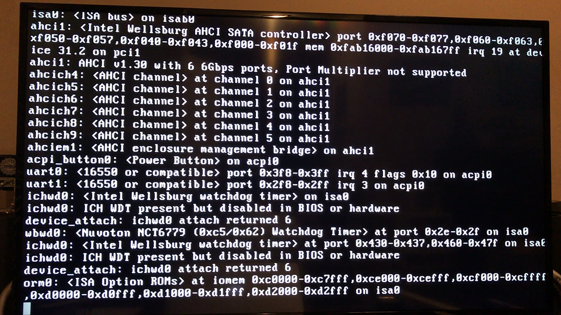

Hey guys, I'm attempting to install FreeNAS v 9.10.2-U2 and FreeNAS-Corral-10.0.2
Neither have installed and both fail/restart at the same point.

This is a non-stop cycle at the same progress point.
The last line I see is the picture I've attached

While you tried unplugging them all the way to 16GB did you try memtest x86? It may be possible that there's something wrong with your memory. Try with different combinations first. Leaving only one module but different ones every time and try again. If again it doesn't work run memtest. I don't think all 4 modules would go bad at the same time but who knows.

Here is the video that happens every time with FreeNAS Corral and the latest 9.1 stable build: https://youtu.be/tbilIKWc_yY
You might want to make sure you don't have any loose watchdogs in the BIOS. Disable them all.
