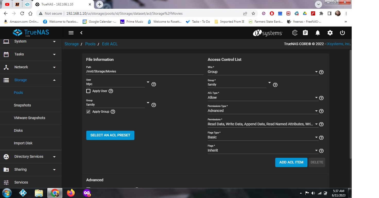

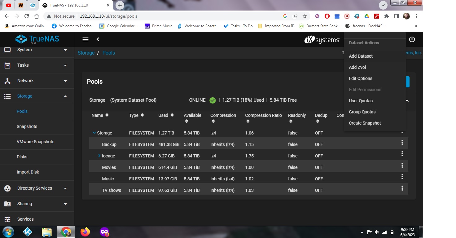

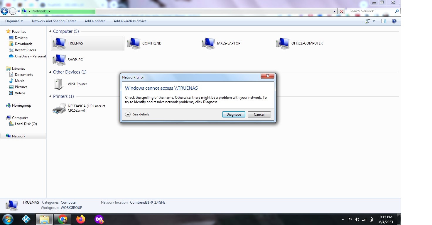

ok guys. I got core reinstalled. When I tried to do my shares it shows ACL present. I've tried to strip all the ACL. but I can't seem to. edit permissions is greyed out. windows as well won't even access the server. any idea what I can do?

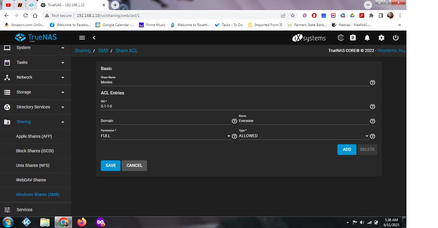

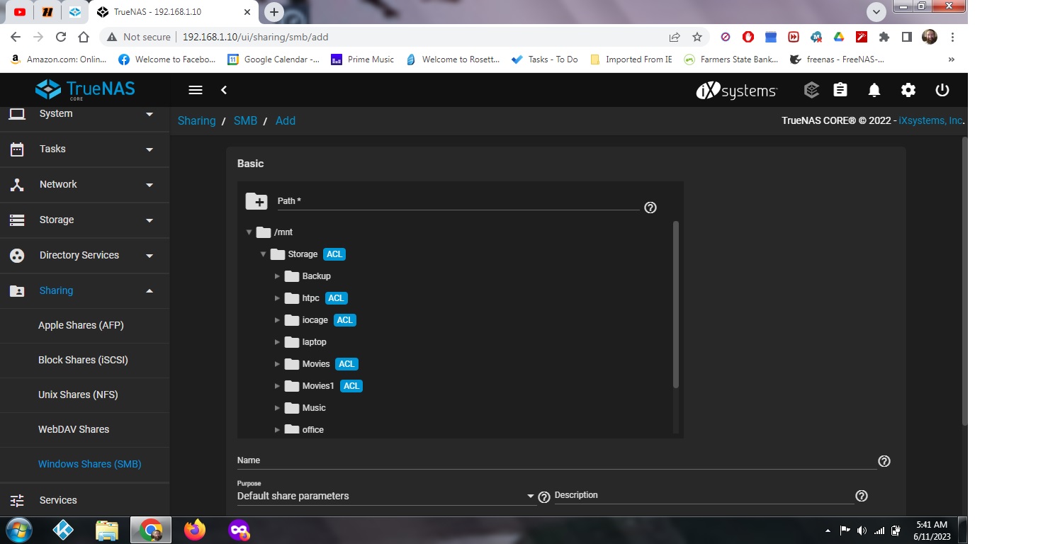

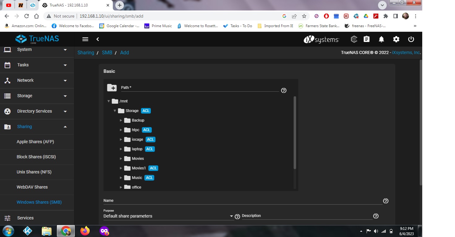

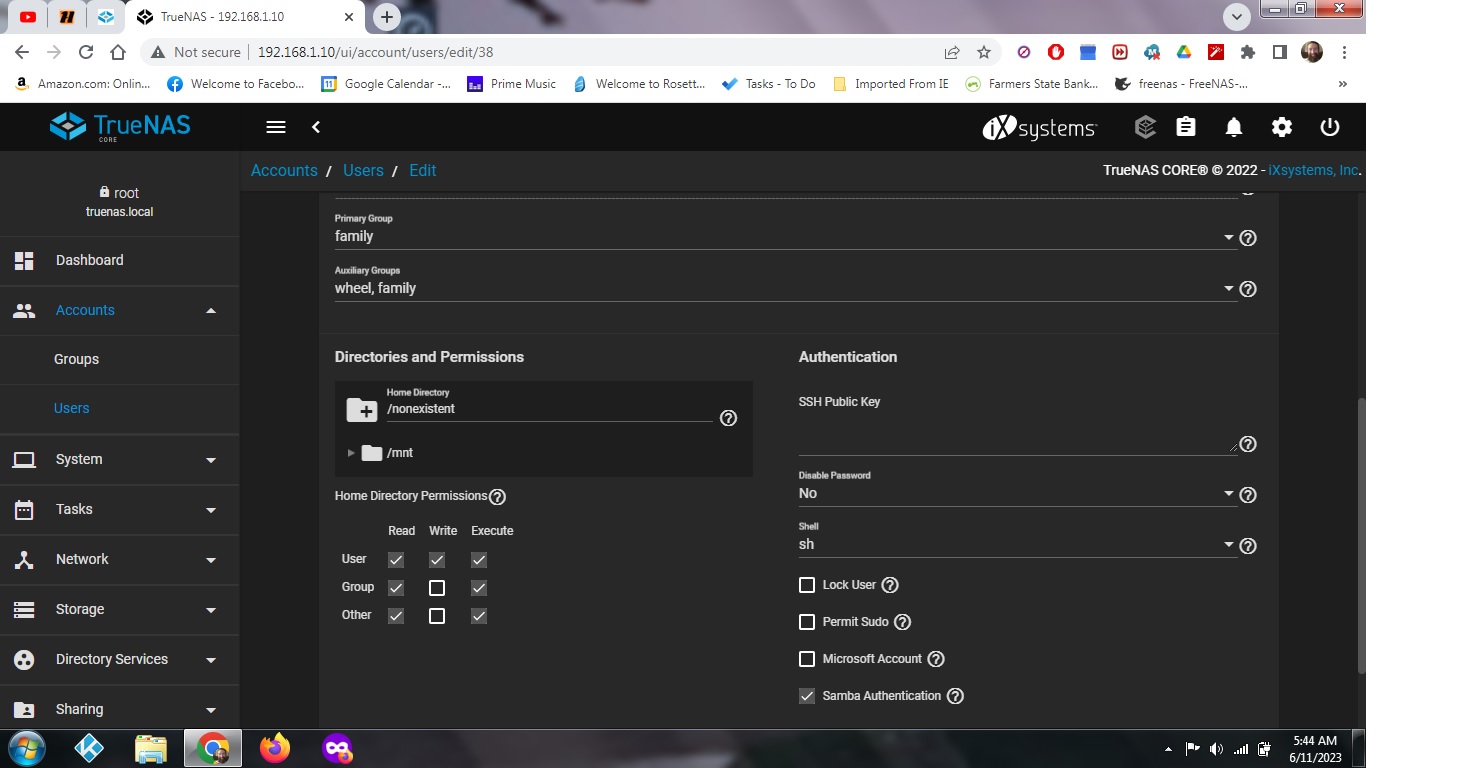

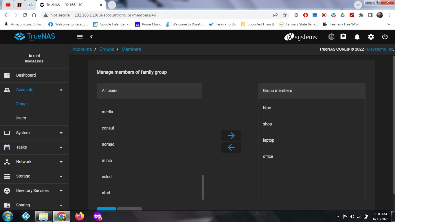

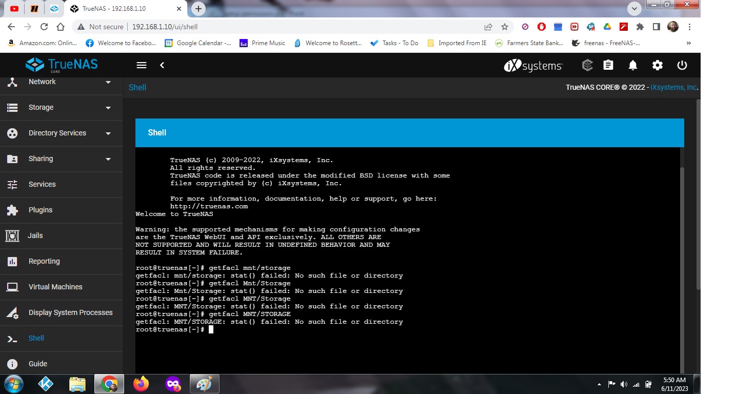

guys I really am trying to figure this out. I really could use some help cause I need to access this data. I've tried setting up users for the 4 computers I have( 2- windows 7, a mint, and a ubuntu) right now I'm trying to set up my movies share. I created a group called family. I think my main problem is the acl that shows up at my pool level. I've tried to edit permissions but its greyed out. I know root can't edit that in core. It was setup in an earlier version. I tried to getfacl but it says its not there. I'm really at a loss on where to go from here but I can't just wipe the pool and start over as it contains info I can't lose

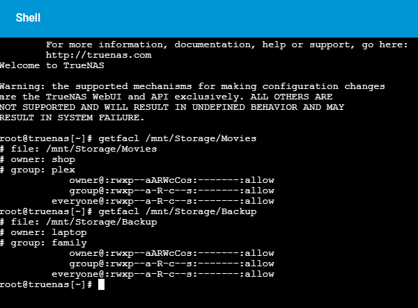

9,700
OK, so the first thing you need to understand is that get/setfacl work with mounted filesystems, not with ZFS objects, so if you want to use them, you need to use a path like this (case sensitive):
/mnt/Storage
pipewelder1
May 31, 2023
8
/mnt/Storage
that was the first way I tried it. all lower case

9,700
No. You're not paying attention to what's important.
You missed the first forwardslash in all of your attempts.
You also never tried the correct combination of case...
mnt all lowercase
Storage with capital S (as in the name you defined for your pool).
go back to what I wrote and think again about your screenshot... did you try it or not?

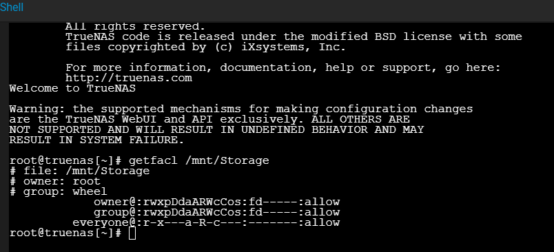

pipewelder1
May 31, 2023
8
mnt all lowercase
9,700
OK, so now you have the right path and you get some output from the command, you need to go back to what you were trying to achieve 7 months ago.
Is your problem that the location you're sharing has the wrong filesystem acls or is it your share acls that need addressing.
You'll need to run getfacl for the dataset you're sharing to check that. (getfacl /mnt/Storage/Movies... or Movies1 ?)

I cant map any of my shares on any computer on my network. So I cant add or delete from the shares. I dont know if I need to change the permissions.
