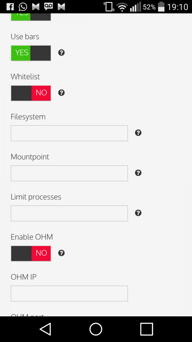

Where should I put this code? It is in one of the spaces in the Setting/System Info?
no, in the jail htpc-manager
is installed to, to verify the path you want to monitor actually exists in the jail

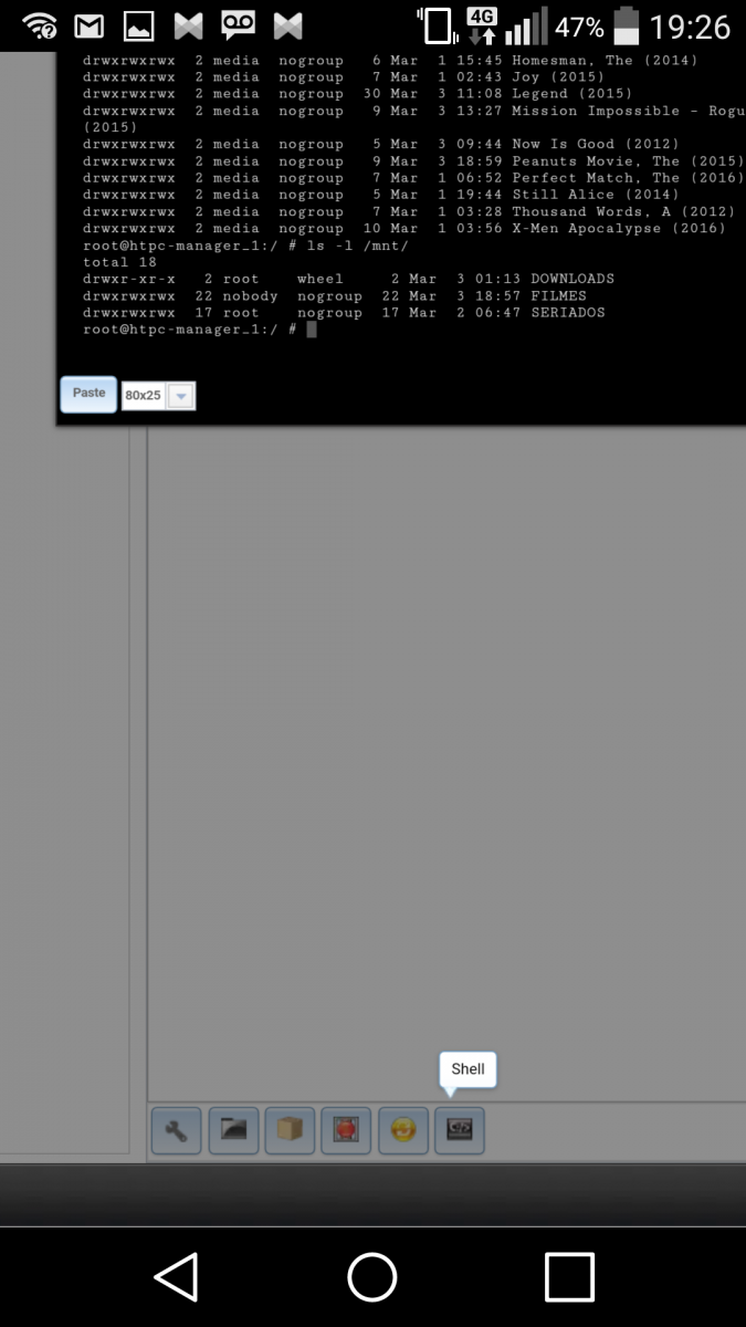

Yeah, I checked they exist, they are FILMES and SERIADOS.

I would ask somewhere specific for htpc-manager help then. looks good to me.
