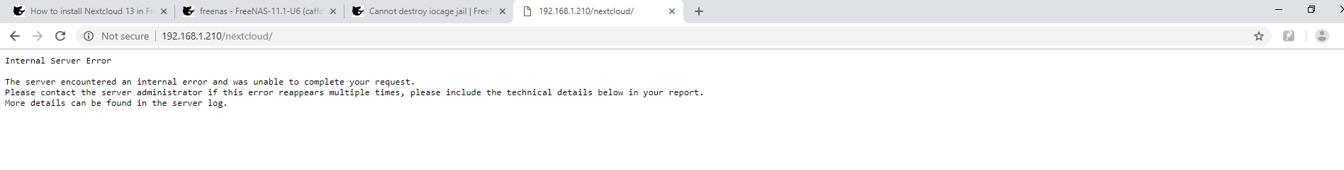

Also the initial configuration of Nextcloud works but after going on in your walkthrough and I try to go to my nextcloud page I get this error:
Internal Server Error
The server encountered an internal error and was unable to complete your request.
Please contact the server administrator if this error reappears multiple times, please include the technical details below in your report.
More details can be found in the server log.
What am i doing wrong here?
Update: the first problem I managed to fix but the second one i am unable to fix.
I don't think the second error has anything to do with nextcloud because i get the error when i try to open the info.php file in my browser.
Update: Fixed it! I removed the whole part about the memcache and resolved the issue not sure why but whatever.

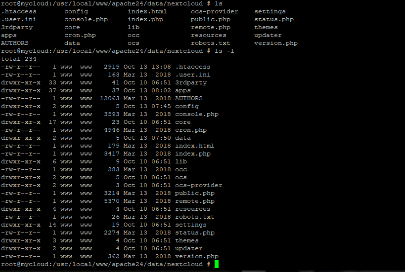

Apache is running, I ran this command "chown -R www:www /usr/local/www/apache24/data/nextcloud /mnt/files" I put just the jail ip address I see "It Works", and jail_IP/info.php I see the PHP info page as well. but when I add jail_ip/nextcloud I got the following error:
"Internal Server Error
More details can be found in the server log."
<VirtualHost *:80>
DocumentRoot "/usr/local/www/apache24/data/nextcloud"
ServerName mycloud.net
RewriteEngine on
RewriteCond %{SERVER_NAME} =mycloud.net
RewriteRule ^ https://%{SERVER_NAME}%{REQUEST_URI} [END,QSA,R=permanent]
#ErrorLog ${APACHE_LOG_DIR}/error.log
#CustomLog ${APACHE_LOG_DIR}/access.log combined
<Directory /usr/local/www/apache24/data/nextcloud/>
Options +FollowSymlinks
AllowOverride All
<IfModule mod_dav.c>
Dav off
</IfModule>
SetEnv HOME /usr/local/www/apache24/data/nextcloud
SetEnv HTTP_HOME /usr/local/www/apache24/data/nextcloud
Satisfy Any
</Directory>
</VirtualHost>
