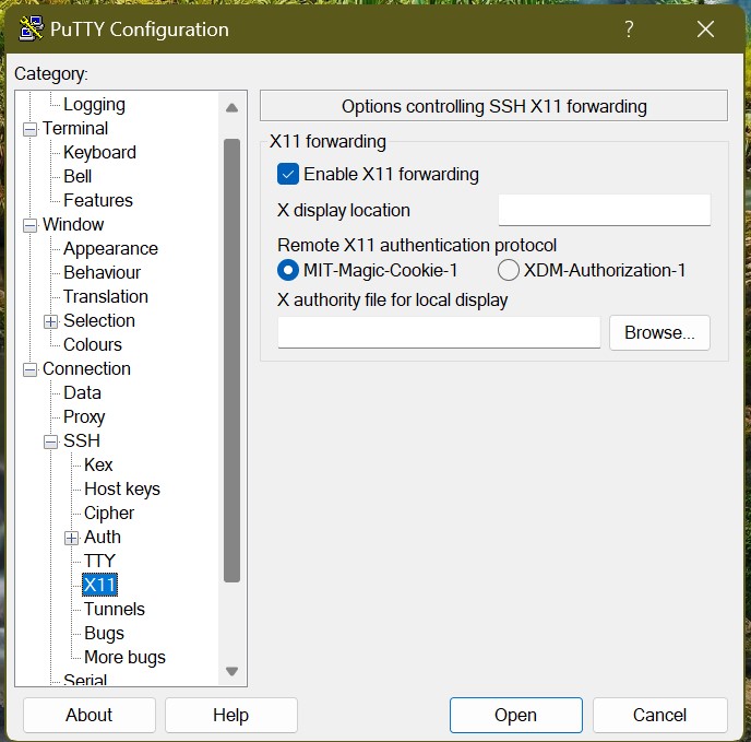

In Putty, you need to set the X display location to :0

9,700
Did you set the X display location to :0
Which pkgs did you install?

From Putty: (EDIT: turns out I was already also running Xming, which is a prerequisite to this working)
Set a connection to your jail's IP
Set on the X11 tab Enable X11 forwarding
Set on the X11 tab the X display location to :0
Save that connection and login as root with the password you set above.
Then in that terminal:
firefox
A firefox window should appear in your Windows session (but is actually running in the jail)...
Let me know which step doesn't work if any. (I have just performed each of these steps on a TrueNAS 13 BETA server as I was typing them, so I confirm it works for me in both Putty and XQuartz.

Lot of Thanks for your help.
