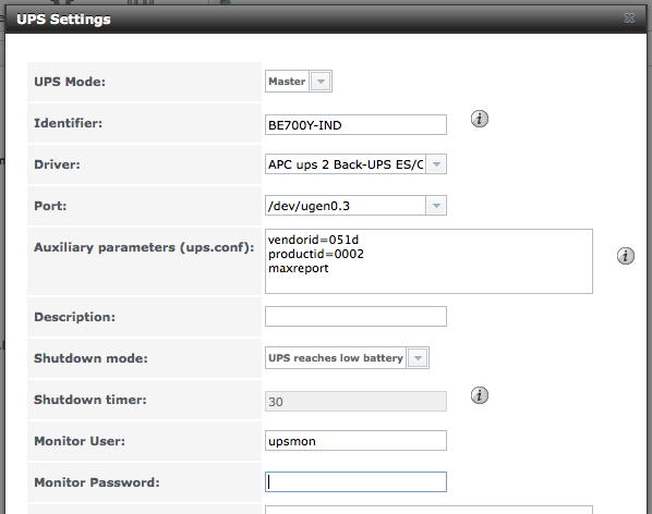

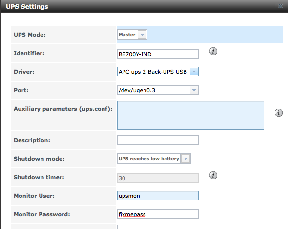

After some googling, I came across this post that advised liberalising the permissions for /dev/ugenX.Y, because the driver needs to read/write to it. I'm not sure what it runs as, so I changed it to 777 but it didn't help me. I also created a upsmon user, gave it a password, changed ownership of the port to it, but still, nothing.
Digging Deeper
After enough Googling I realised that the GUI translates to /etc/local/nut/ups.conf. Mine looked like this:
index.php
And the ups.conf was
[BE700Y-IND]
driver = usbhid-ups
port = /dev/ugen0.3
desc = ""
Note that there is no mention of exactly which driver was selected in the GUI. The selection of UPS model in the GUI only helps narrow down the choice of driver to usb, generic (serial) or network.
The documentation for usbhid-ups, upsdrvctl & ups.conf mention some ways of debugging/printing what happens when the UPS driver tries to communicate with your UPS, but its not obvious how to do that from the GUI. This page mentions how to run the usb driver "by hand", which is also what is attempted when you try to turn on the UPS service from FreeNAS GUI. Basically, it runs

So, the driver can "see" my ups at ugen0.3 just fine, only that it doesn't realize its an UPS that it can talk to. So may be I need to be more specific about exactly what to look for?
The manpage for usbhid-ups lists all the parameters that can be passed to the driver, so I tried to make it as specific as possible:
[BE700Y-IND]
driver = usbhid-ups
port = /dev/ugen0.3
desc = ""
vendorid=051d
serial=XXXXXXXXXXXX
productid=0002
vendor=American.Power.Conversion
product=Back-UPS.ES.700Y-IND.*
bus=/dev/usb
Still, no dice. And it was getting painful switching back & forth between the terminal and the GUI. I needed some way to pass these parameters from the command-line itself. And, sure enough, the man page for usbhid-ups and "/usr/local/libexec/nut/usbhid-ups -h" would both tell you how to: just use the "-x" flag. So I tried this
sudo /usr/local/libexec/nut/usbhid-ups -DD -x vendorid=051d -x productid=0002
But then you'd get
Network UPS Tools - Generic HID driver 0.38 (2.7.1)
USB communication driver 0.32
0.000000 Error: specifying '-a id' is now mandatory. Try -h for help.
So, you must have a section created in /etc/local/nut/ups.conf with minimal information, while the rest can be passed the rest from command line.
Also, last time, I was probably too specific. May be I passed "too much information" to the driver? This time, I'd only be as specific as I need to be. So the ups.conf looks like
[BE700Y-IND]
driver = usbhid-ups
port = /dev/ugen0.3
desc = ""
while I ran
sudo /usr/local/libexec/nut/usbhid-ups -DD -x vendorid=051d -x productid=0002 -a BE700Y-IND
And voila! something was happening!

0.917943 refresh_report_buffer: expected 5 bytes, but got 3 instead
The elation didn't last very long, once I actually looked at what was scrolling past. There were error messages. Look at the last line, for example:
Fortunately, the manpage for usbhid-ups had this:
maxreport
With this option, the driver activates a tweak to workaround buggy firmware returning invalid HID report length. Some APC Back-UPS units are known to have this bug.​
Next attempt was this:
sudo /usr/local/libexec/nut/usbhid-ups -DD -x vendorid=051d -x productid=0002 -a BE700Y-IND -x maxreport

I guess it was time to try to turn the UPS service on, with these parameters. Also, I had nothing left to try to debug, anyway. Only that, these additional parameters need to be specified in the GUI, so FreeNAS would write them into its sqlite db and therefore would survive a reboot. This is what the final UPS settings screen looked like
index.php
I actually created a upsmon user with a valid password. I don't know if that's really necessary.
With these, the UPS service turned on without any fuss.
This morning, I had to restart my server to reset its network. The usb permissions I had set up were gone, but the UPS service was still on. It probably works too, since I got an email this morning when the power went down for a minute, and also when it came back up. I have yet to test actual shutdown/restart.
