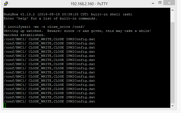

@theirman - given that your boards have only recently died (and you may not have sent them back yet), it would be really interesting to see whether you've suffered the same fate. In my case, the BMC was still running and I was able to temporarily resurrect my board by logging into IPMI, making a couple of trivial configuration changes (it doesn't matter what - logging config would be a good example), saving changes, removing power from the wall and then successfully booting up. Might take a couple of goes.
If you can get your system going again, boot into FreeNAS (I'd recommend disconnecting your precious disks before doing this), TelNet or SSH into your IPMI IP address, then run the command:
inotifywait -mr -e close_write /conf/
In a bad system, you'll see the following file written to every second:
conf/BMC1/ CLOSE_WRITE,CLOSE IPMIConfig.dat
It won't bring your board back, but at least you'll know you're in the club!!

Don't forget to disable the watchdog in BIOS and FreeNAS on your Asrock c2550d4i;
https://forums.freenas.org/index.ph...2x50-d4i-boards-by-disabling-the-watchdog.16/
Watchdog has been disabled in the bios since about day 2 because I was getting random resets with it enabled and zero problems once disabled in BIOS. I have not disabled it in FreeNAS. When booting I remember it saying something along the lines of "watchdog present but hardware disabled," yet it was still getting written every 1s.
Thanks
edit: was still being written to every second.... Fuc/<
edit: maybe I should order a replacement chip now to have on hand when/if it dies.
If you're on 9.10.1-U3 or later, the watchdog should be patted in a way that makes it not write its configuration to flash. The downside is that it also doesn't do its job, so it might as well be disabled.
