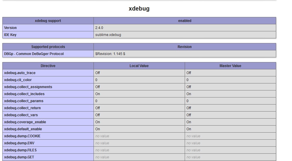

I have a question, even though I got the xdebug to install on php but there is no xdebug log file since its written no value. Even though I put these xdebug lines on php.ini
extension=/usr/local/lib/php/20131226/xdebug.so
xdebug.profiler_enable = 1
xdebug.profiler_output_dir = /tmp/profiler
xdebug.remote_enable=On
xdebug.remote_host="localhost"
xdebug.remote_port=9000
xdebug.remote_handler="dbgp"
xdebug.remote_autostart=1
but there is no xdebug log file created.

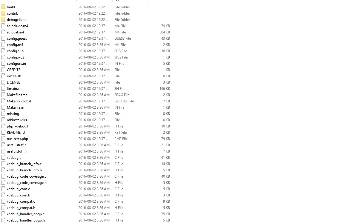

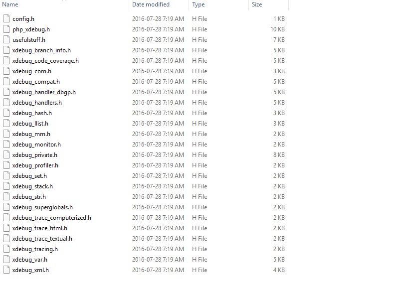

I've decided to not use tmp/profiler since it does not exist and I did search for the package install php-xdebug the one I recently installed and the result shows.
php-xdebug-2.4.0_1 Xdebug extension for PHP
also when I check the folder for xdebug it looks like:
//davidjones/davidjonesdataset/jonesserver/usr/local/include/php/ext/xdebug/
or
//davidjones/davidjonesdataset/xdebug2.4.1/xdebug/
and I've tried:xdebug.profiler_output_dir="//davidjones/davidjonesdataset/jonesserver/usr/local/include/php/ext/xdebug/xdebug_profiler.h" and it does it not work when debugging.
I bascially want to get that xdebug into that sublime text 3 just like this one.
https://www.youtube.com/watch?v=rC2j1EKkL5E
pirateghost
Unintelligible Geek
Feb 29, 2012
4,219
It appears you aren't grasping the folder structure or what that directory is for.
Create a directory within your jail.
Point your xdebug to it.
That's it. Don't use the directory that the installation created for the binary or the libraries, and don't give it full paths outside your jail (it doesn't know what that path is, all it knows is the path inside the jail)

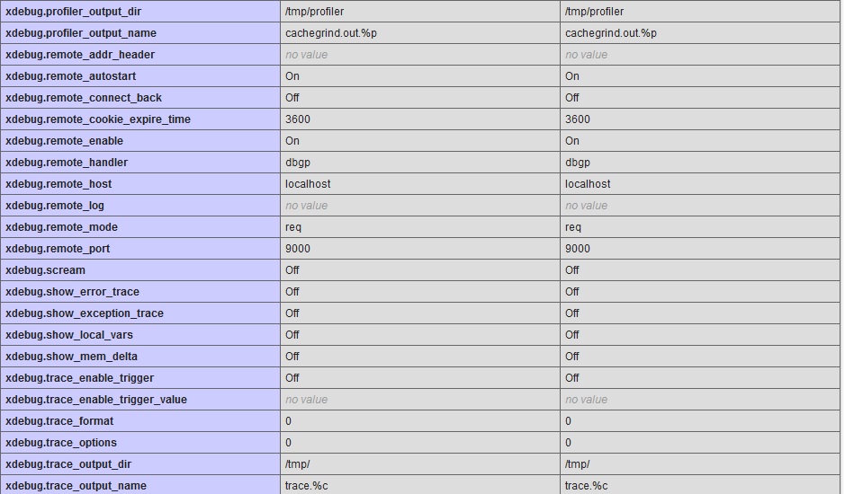

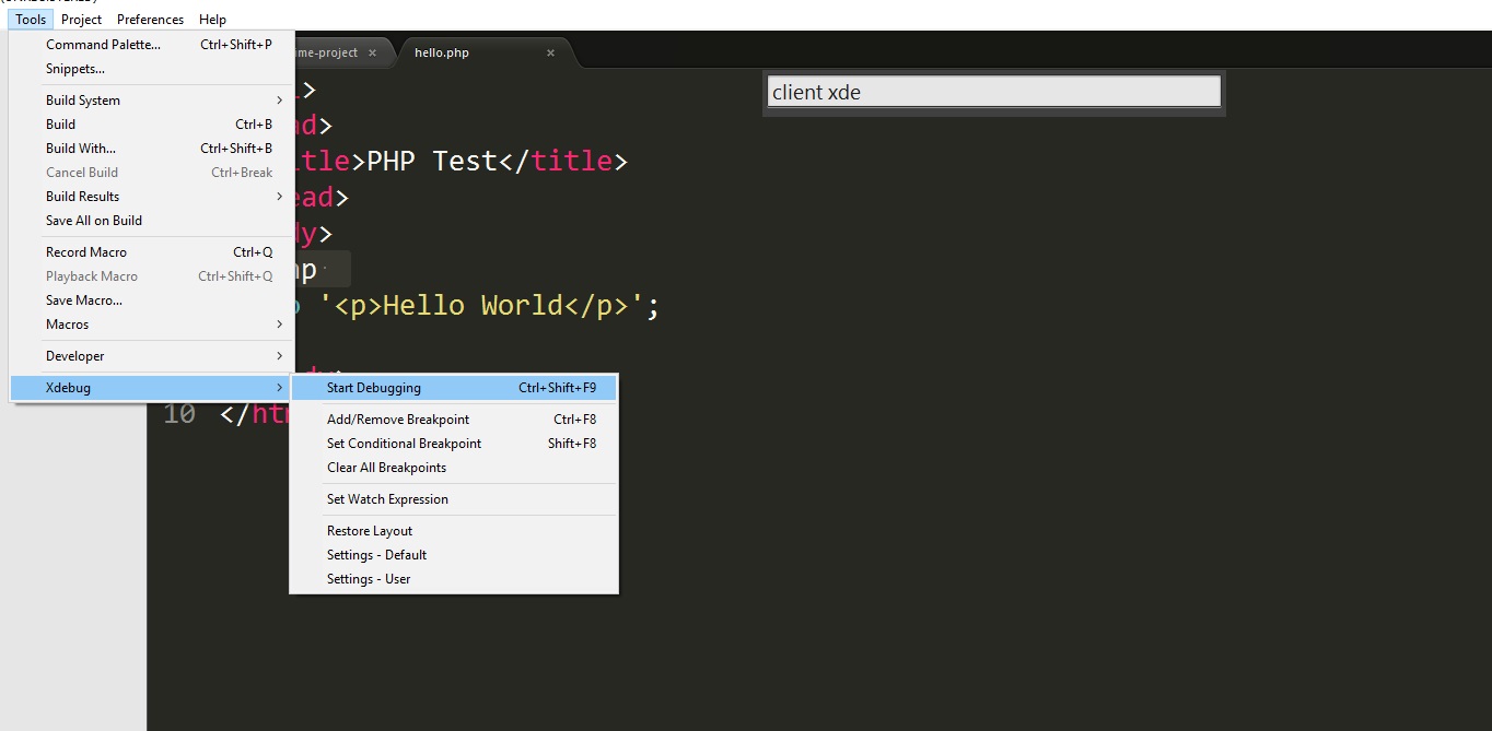

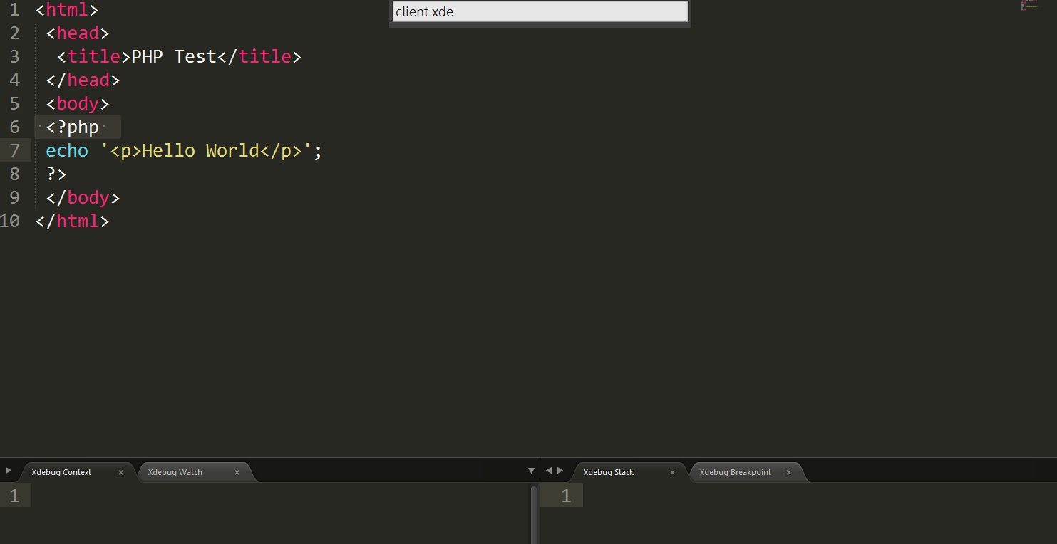

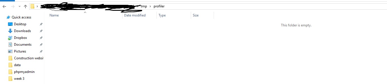

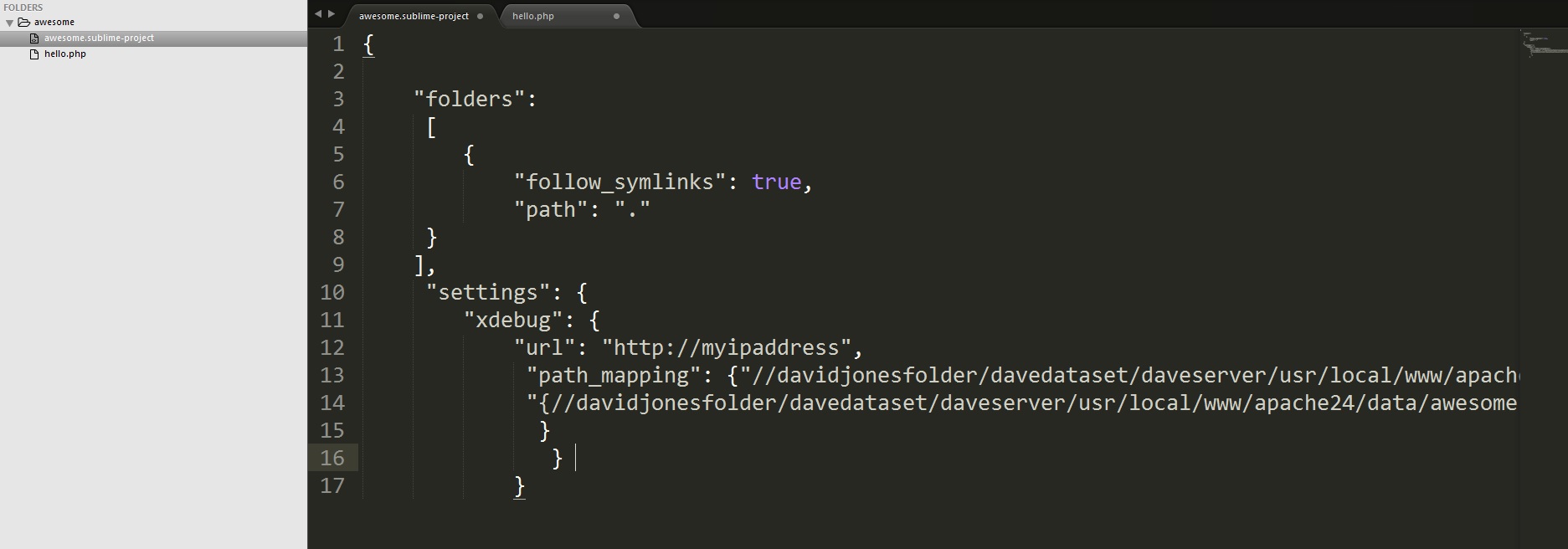

I basically want to get the debugger program to work on the sublime text 3. I just created enter the command line of mkdir -p /tmp/profiler and then went back to php.ini file and change it back to xdebug.profiler_output_dir = /tmp/profiler save it and then in the command line I type the command restart apache24 service. Here's the picture of what the xdebug looks like for profiler
Then after that here's the picture of what it looks like under xdebug tmp profiler folder picture which is:
//davidjones/davidjonesdataset/jonesserver/tmp/profiler
and in that profiler folder there is no files.
also, here's the picture of what the file I'm been trying to execute my hello.php and I just want the file to go into the debug mode just like that video. https://www.youtube.com/watch?v=rC2j1EKkL5E

pirateghost
Unintelligible Geek
Feb 29, 2012
4,219
In your sublime text project, you have http://myipaddress, have you actually put in your jail IP?
Once connected to the jail IP, the path should be relative to the jail, so the path mapping should be /tmp/profiler
