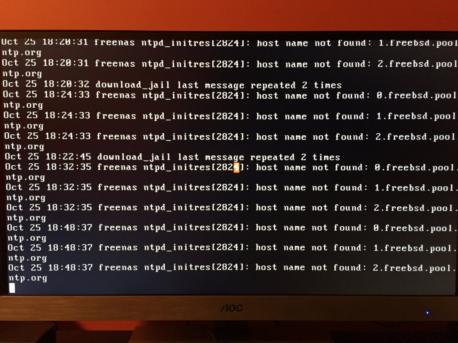

I have had this issue before and it seems to only happen when I do a hard reset on the server. Last time I just re-installed on different flash drive and started from scratch. I do have a backup of the config this time, thankfully. Just wondering how to fix so I can access the web gui without doing a complete re-install.
I have tried to ping "8.8.8.8" via shell and don't get a response. I can not ssh into it either. I attached the pic of the error I'm getting. I've done some quick searches with no luck.

It would help if you post version of FreeNAS that you are running. Any how 9.2 branch which I am running has as one of console optios network which allows you to set IP, gateway and DNS.
