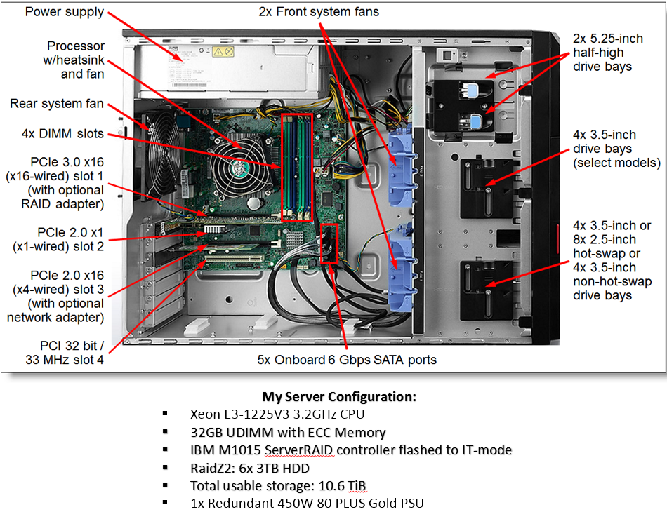

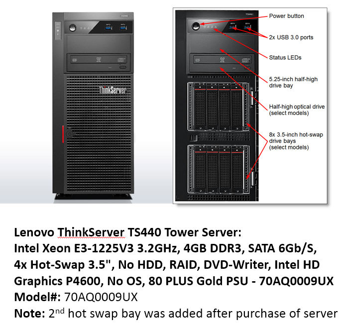

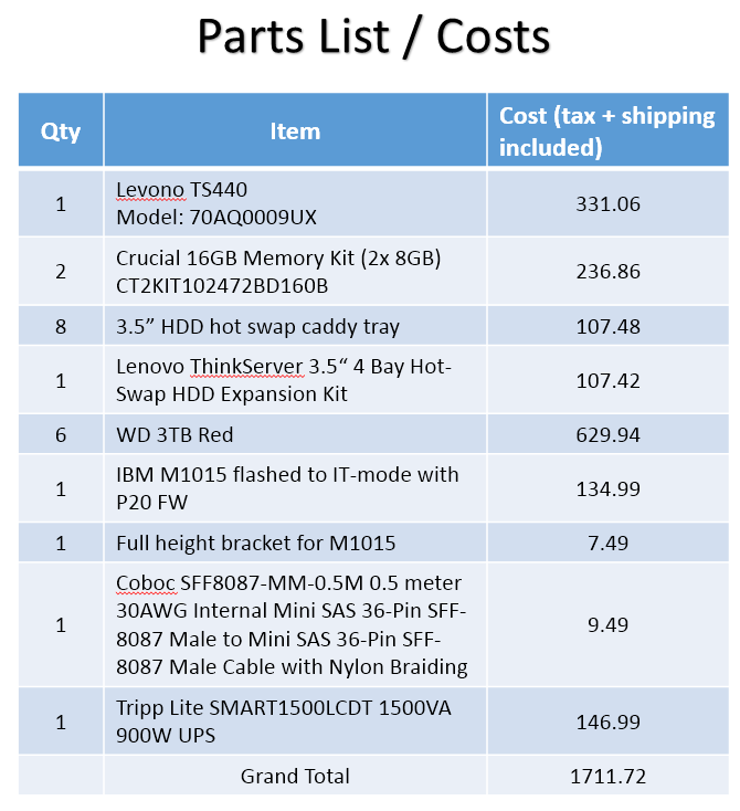

I got started on this journey about the middle of 2015. I was talking with a colleague at work expressing my desire to build a Network Attached Storage for all my media (high resolution music files mainly flac and wav, pictures, documents, etc). He suggested to take a look at "FreeNAS" so I started reading the Forums. I read "A Complete Guide to FreeNAS Hardware Design", the ZFS Primer and various members' build experience posts. Around September last year, I received a promotional email from TigerDirect and saw a Levono ThinkSever TS440 with a 3.2G Xeon cpu, 4GB DDR3 EEC RAM, 4 slot hot swap HDD bay but no HDDs, 5 Sata3 ports, DVD writer, an integrated 1G Intel network interface and Intel HD Graphics, 450W 80 Plus Gold PSU. Price was $299.99. Even though it did not come with an OS and HDDs, I thought that was still a very good price so it pushed me over the edge! I decided then to build my FreeNAS based media server and started buying all the additional hardware. From what I was learning, I decided on a 6 drive RaidZ2 array which I thought was a good compromise for cost, performance and capacity. Since the server only came with 4 hot swappable HDD bays I decided to add another 4 slot hot swappable bay. Here are some pictures of the server and the parts list:
Notice that I purchased the M1015 already flashed to IT-mode with P20 firmware. I initially bought a board that was not flashed to IT-mode. Unfortunately, after attempting to flash it, I got the dreaded "failed to initialize PAL" error message. I tried flashing it using my other two PCs with the same result. Then I frustrated and put the project aside. A few weeks ago, while searching ebay, I found someone selling the board already flashed to IT-mode. So I bit the bullet and paid the extra $50 for the flashed board.
