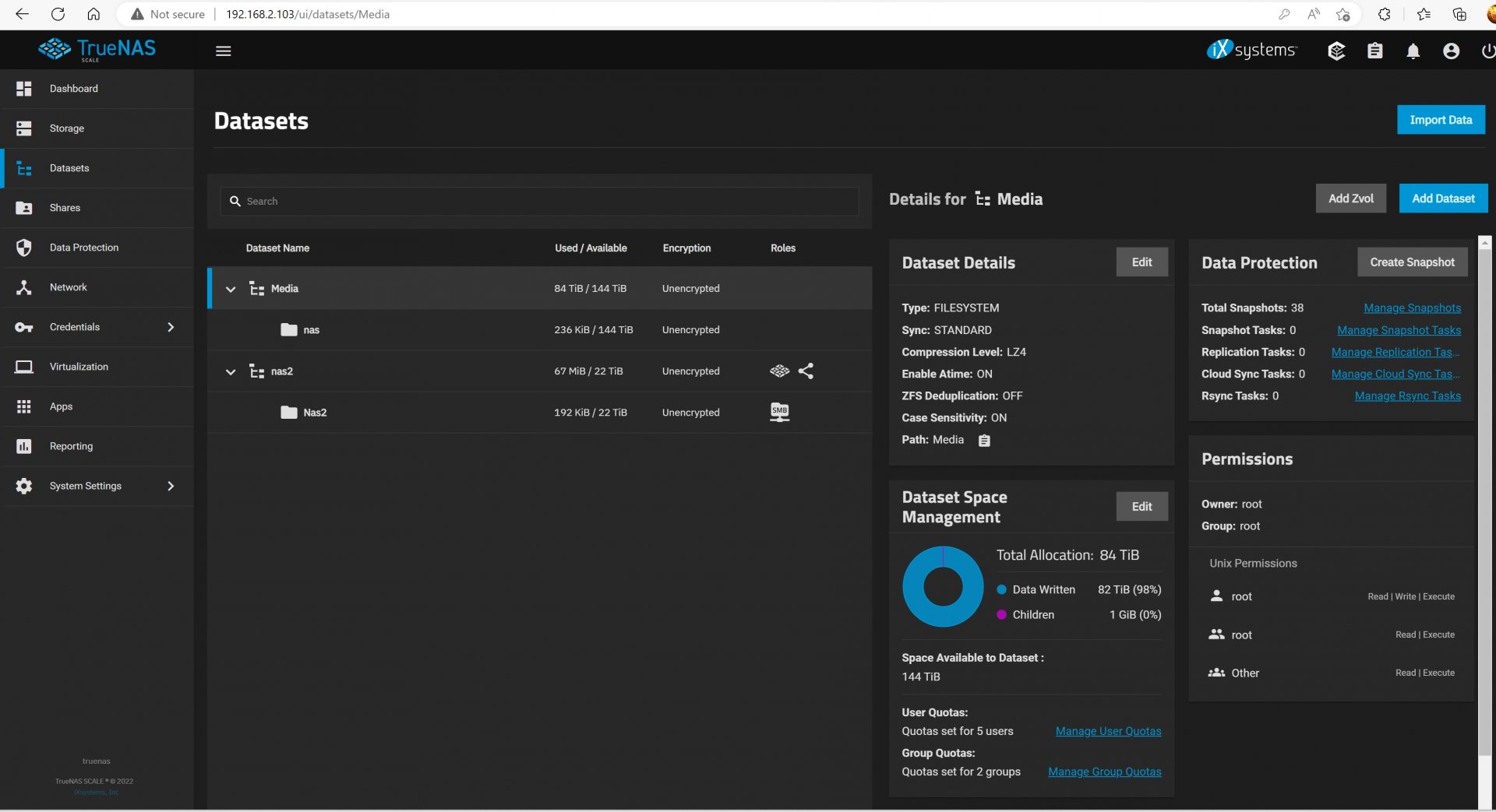

Having issue importing a zfs pool from OM6
no1ninja
Jan 22, 2013
24
The pool imports no problem, it is seen and comes up with perfect health.
I then try to make a data set for it calling it "nas" and get this msg:
error CallError​
[ENOENT] Path not found [/mnt/Media].
I have no problems making ZFS pools from scratch, but importing is fraught with error after error. I don't know what to do, that ZFS pool has 85TB that I need.
Also even though the error comes up, it still makes the folder MEdia under neath it but it acts like if its just a dataset for the freespace, does not include any of my data. The ZFS is 85TB/144TB.... but the new data sat is 239bytes/144TB
Trying to share it makes the errors get worse and worse. I am new to freeNAS so I am lost I don't know what to do. I know the 1st error above comes when creating the dataset, and the dataset only shows freespace and none of my data.

no1ninja
Jan 22, 2013
24
More info...
File "/usr/lib/python3/dist-packages/middlewared/main.py", line 181, in call_method
result = await self.middleware._call(message['method'], serviceobj, methodobj, params, app=self)
File "/usr/lib/python3/dist-packages/middlewared/main.py", line 1266, in _call
File "/usr/lib/python3/dist-packages/middlewared/main.py", line 1169, in run_in_executor
File "/usr/lib/python3.9/concurrent/futures/thread.py", line 52, in run
File "/usr/lib/python3/dist-packages/middlewared/schema.py", line 1288, in nf
return func(*args, **kwargs)
File "/usr/lib/python3/dist-packages/middlewared/schema.py", line 1158, in nf
res = f(*args, **kwargs)
File "/usr/lib/python3/dist-packages/middlewared/plugins/filesystem.py", line 597, in acl_is_trivial
raise CallError(f'Path not found [{path}].', errno.ENOENT)
middlewared.service_exception.CallError: [ENOENT] Path not found [/mnt/Media].
no1ninja
Jan 22, 2013
24
How do create a dataset without getting the above error? I tried everything I could.

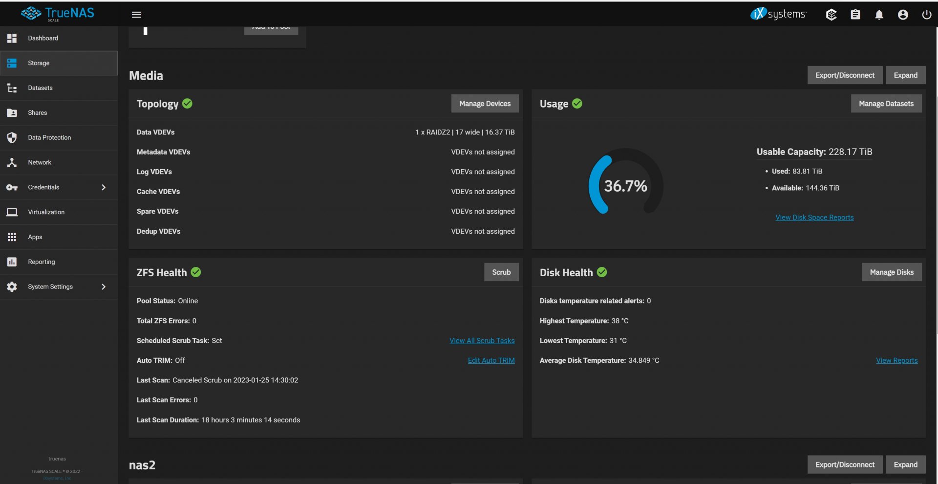

Arwen
May 17, 2014
3,611
First off, can you supply the output of the following commands in code tags?
zpool status zpool list -v zfs list -t all -r zfs get mountpoint
It appears, (without having the above command outputs), you put all the 84TB in top level dataset. In general, it is best to have different datasets for different purposes. Even if the ZFS pool is all one purpose.
Next, you already have a "Media/nas" dataset.
Last, it is not recommended to have very wide RAID-Zx vDevs. The output of the second screen capture indicates you have a 17 disk wide RAID-Z2. Performance can be spotty whence the pool starts to fill up or get fragmented. Nothing to work on today, just something you should be aware of. In general, 12 disks is considered roughly the maximum, though others may think it is lower or slightly higher.

Thank you so much for helping me.
My trueNAS does not seem to understand these commands. I type them in the shell, and SSH and in both instances it says bad command not recognized.
zpool is not understood at all. Nor are any zfs commands. My previous install of OpenMediaVault understood all these commands but the true NAS I installed does not. I downloaded the latest stable copy. TrueNAS 22.12.ISO.
I have a server with 36 drives, and I wanted to use it as my media server for plex. It runs perfectly under OMV6, but I was not happy with the performance, I have 10GBE NIC on both ends, and only get reads of 100MB/s-150MB/s while writes go fast up to 1GB/sbut ussually 750Mb/s.
I have 160GB RAM with 256GB more on order.
I also am waitting for 2.5 inch caddies to mount a 4TB L2ARC.
I am new to ZFS so I am don't know the best design practices if you could guide me that would be amazing.
I will have over 30 18TB drives, and 1TB ssd x 4 drives for L2ARC.
I was going to do this in OMV6 but read that trueNAS has native support of ZFS and I figured that my performance problems will be fixed if I migrated to it. I can't understandt why I am getting such crummy reads when 10gbe cards are on both ends and there are so many drives, the writes I have no problems with as it is very very fast.
so back to my issue, how do I execute the commands in trueNAS when it does not seem to have the basic libraries and commands installed. I am new to unix and debian and did everything from examples on the OMV6 system. It works and I love ZFS, just thought it was a OMV6 issue as no matter what I did on that system, mount 1 drive, or make a zfs with 6 drives, the reads were always limited to 100-150MB/s. 100Mb/s on this first one, and 150Mb/s once it was in memory.
I am pulling my hair out with trueNAS, doesn't even understand zfs commands natively.

There is no "best design". There is simply a set of compromises that best match your use case

Can 2 pools of 12 drives be made, or 3 pools of 10 drives, in such a configuration that it is all mounted as one drive? Is that possible under zfs?
Whattteva
Mar 5, 2013
1,824
I think you need to read the ZFS primer. Pools consist of vdevs, which then consist of your individual drives. Each pool then coincides to a mount point. So if you create 2 pools, you will end up with 2 mount points, 3 pools = 3 mount points, so on and so forth. How you arrange the drives in the vdevs is up to preference. You can have a bunch of mirrored vdevs or a RAIDZ type vdev. What you should use/prefer depends on your use case and risk tolerance.

root@truenas[~]# zpool status
pool: Media
state: ONLINE
scan: scrub canceled on Wed Jan 25 14:30:02 2023
config:
NAME STATE READ WRITE CKSUM
Media ONLINE 0 0 0
raidz2-0 ONLINE 0 0 0
ee7c0b2d-25ca-c549-81f9-e05854d986c7 ONLINE 0 0 0
0d25223b-e373-8845-9292-cd737b7ff150 ONLINE 0 0 0
389cc3fb-8d92-b84d-83dc-a846ef8dd5f0 ONLINE 0 0 0
c7d3b1d5-caa9-6543-b8a6-da6019be34bf ONLINE 0 0 0
bfa2d4af-d979-9347-8a35-50a781bef9f0 ONLINE 0 0 0
e626ebfb-f5b2-d64a-b1f3-2aa7f732c6a8 ONLINE 0 0 0
f637ff90-1221-1647-b1e3-4bccd50352dc ONLINE 0 0 0
761308c0-a5e2-be4b-9862-bd8db319ca4b ONLINE 0 0 0
7b38c2c3-7c65-b64d-8074-acaf5f34d615 ONLINE 0 0 0
33716810-edc2-cc46-a1fd-ae050ee1d928 ONLINE 0 0 0
b27f7b08-a723-5d47-ab75-55ffb990703c ONLINE 0 0 0
4309bd7f-a2d6-0e47-bd58-194d07acbd94 ONLINE 0 0 0
8b189ec5-35e0-7d4d-8434-386fe9f36fb9 ONLINE 0 0 0
fc14c43d-073e-a441-af7a-01e81aa4b1e9 ONLINE 0 0 0
e3c2401a-7a16-b14f-9004-3356fed12fe1 ONLINE 0 0 0
c0c0a23a-ce4c-6748-b0dc-59ed462e6a01 ONLINE 0 0 0
db32a415-a58c-654b-a69f-c91ad1502706 ONLINE 0 0 0
errors: No known data errors
pool: boot-pool
state: ONLINE
config:
boot-pool ONLINE 0 0 0
sda3 ONLINE 0 0 0
pool: nas2
state: ONLINE
config:
nas2 ONLINE 0 0 0
7ac44cb4-9672-4137-ae4f-18aa30b5bdd9 ONLINE 0 0 0
cd5d56b6-98bb-44db-9d94-782041be3c5e ONLINE 0 0 0
f139eebb-c677-475d-bdb3-a22d406f8f7b ONLINE 0 0 0
58a8feca-45dd-4493-b075-1e34eb4cf394 ONLINE 0 0 0
30a8b7a6-0777-4586-8b86-38c4ea77f960 ONLINE 0 0 0
05b22030-0191-412b-8926-e5a16e80ef7f ONLINE 0 0 0
dont worry about the last zpool i was testing to see how i could get freenas to work and i will be deleting it
no1ninja
Jan 22, 2013
24
root@truenas[~]# zpool list -v
NAME SIZE ALLOC FREE CKPOINT EXPANDSZ FRAG CAP DEDUP HEALTH ALTROOT
Media 278T 102T 176T - - 0% 36% 1.00x ONLINE /mnt
raidz2-0 278T 102T 176T - - 0% 36.7% - ONLINE
ee7c0b2d-25ca-c549-81f9-e05854d986c7 16.4T - - - - - - - ONLINE
0d25223b-e373-8845-9292-cd737b7ff150 16.4T - - - - - - - ONLINE
389cc3fb-8d92-b84d-83dc-a846ef8dd5f0 16.4T - - - - - - - ONLINE
c7d3b1d5-caa9-6543-b8a6-da6019be34bf 16.4T - - - - - - - ONLINE
bfa2d4af-d979-9347-8a35-50a781bef9f0 16.4T - - - - - - - ONLINE
e626ebfb-f5b2-d64a-b1f3-2aa7f732c6a8 16.4T - - - - - - - ONLINE
f637ff90-1221-1647-b1e3-4bccd50352dc 16.4T - - - - - - - ONLINE
761308c0-a5e2-be4b-9862-bd8db319ca4b 16.4T - - - - - - - ONLINE
7b38c2c3-7c65-b64d-8074-acaf5f34d615 16.4T - - - - - - - ONLINE
33716810-edc2-cc46-a1fd-ae050ee1d928 16.4T - - - - - - - ONLINE
b27f7b08-a723-5d47-ab75-55ffb990703c 16.4T - - - - - - - ONLINE
4309bd7f-a2d6-0e47-bd58-194d07acbd94 16.4T - - - - - - - ONLINE
8b189ec5-35e0-7d4d-8434-386fe9f36fb9 16.4T - - - - - - - ONLINE
fc14c43d-073e-a441-af7a-01e81aa4b1e9 16.4T - - - - - - - ONLINE
e3c2401a-7a16-b14f-9004-3356fed12fe1 16.4T - - - - - - - ONLINE
c0c0a23a-ce4c-6748-b0dc-59ed462e6a01 16.4T - - - - - - - ONLINE
db32a415-a58c-654b-a69f-c91ad1502706 16.4T - - - - - - - ONLINE
boot-pool 7.25T 2.64G 7.25T - - 0% 0% 1.00x ONLINE -
sda3 7.26T 2.64G 7.25T - - 0% 0.03% - ONLINE
nas2 32.7T 14.3G 32.7T - - 0% 0% 1.00x ONLINE /mnt
raidz2-0 32.7T 14.3G 32.7T - - 0% 0.04% - ONLINE
7ac44cb4-9672-4137-ae4f-18aa30b5bdd9 5.46T - - - - - - - ONLINE
cd5d56b6-98bb-44db-9d94-782041be3c5e 5.46T - - - - - - - ONLINE
f139eebb-c677-475d-bdb3-a22d406f8f7b 5.46T - - - - - - - ONLINE
58a8feca-45dd-4493-b075-1e34eb4cf394 5.46T - - - - - - - ONLINE
30a8b7a6-0777-4586-8b86-38c4ea77f960 5.46T - - - - - - - ONLINE
05b22030-0191-412b-8926-e5a16e80ef7f 5.46T - - - - - - - ONLINE
root@truenas[~]# zfs list -t all -r
NAME USED AVAIL REFER MOUNTPOINT
Media 83.8T 144T 82.4T /mnt/data
Media@zfs-auto-snap_daily-2023-01-20-1251 51.1M - 37.3T -
Media@zfs-auto-snap_daily-2023-01-21-1305 20.6G - 55.6T -
Media@zfs-auto-snap_daily-2023-01-22-1310 173G - 76.9T -
Media@zfs-auto-snap_daily-2023-01-23-1331 40.3G - 82.6T -
Media@zfs-auto-snap_daily-2023-01-24-1323 111M - 82.4T -
Media@zfs-auto-snap_daily-2023-01-25-1313 0B - 82.2T -
Media@zfs-auto-snap_weekly-2023-01-25-1313 0B - 82.2T -
Media@zfs-auto-snap_daily-2023-01-27-1314 106M - 82.2T -
Media@zfs-auto-snap_daily-2023-01-28-1313 1.96M - 82.2T -
Media@zfs-auto-snap_hourly-2023-01-29-0417 0B - 82.2T -
Media@zfs-auto-snap_hourly-2023-01-29-0517 0B - 82.2T -
Media@zfs-auto-snap_hourly-2023-01-29-0617 197K - 82.2T -
Media@zfs-auto-snap_hourly-2023-01-29-0717 1.44M - 82.2T -
Media@zfs-auto-snap_hourly-2023-01-29-0817 3.85M - 82.2T -
Media@zfs-auto-snap_hourly-2023-01-29-0917 1.77M - 82.2T -
Media@zfs-auto-snap_hourly-2023-01-29-1017 1.23M - 82.2T -
Media@zfs-auto-snap_hourly-2023-01-29-1117 2.02M - 82.2T -
Media@zfs-auto-snap_hourly-2023-01-29-1217 866K - 82.2T -
Media@zfs-auto-snap_daily-2023-01-29-1240 0B - 82.2T -
Media@zfs-auto-snap_hourly-2023-01-29-1317 0B - 82.2T -
Media@zfs-auto-snap_hourly-2023-01-29-1417 1.46M - 82.2T -
Media@zfs-auto-snap_hourly-2023-01-29-1517 394K - 82.3T -
Media@zfs-auto-snap_hourly-2023-01-29-1617 0B - 82.3T -
Media@zfs-auto-snap_hourly-2023-01-29-1717 0B - 82.3T -
Media@zfs-auto-snap_hourly-2023-01-29-1817 866K - 82.4T -
Media@zfs-auto-snap_hourly-2023-01-29-1917 472K - 82.4T -
Media@zfs-auto-snap_hourly-2023-01-29-2017 0B - 82.4T -
Media@zfs-auto-snap_hourly-2023-01-29-2117 0B - 82.4T -
Media@zfs-auto-snap_hourly-2023-01-29-2217 0B - 82.4T -

root@truenas[~]# zfs get mountpoint
NAME PROPERTY VALUE SOURCE
Media mountpoint /mnt/data local

I would just like to be able to read and write to the 1st pool at this time /Media. I will read the primer, but I still need to get my data.
Whattteva
Mar 5, 2013
1,824
can you raid 0 the mountpoints? to make 1 device?
No, what you need to do is create one pool and stripe the vdevs. Also, you can't really modify RAIDZ vdevs once created, so you're stuck with it.
Your pools look fine. I think all you need to do is probably just a zfs export Media` from the command line and then reimport the pool from the web UI.
Whattteva
Mar 5, 2013
1,824
Also, for goodness sake, please format your console dumps in CODE tags. They're so hard to read.
no1ninja
Jan 22, 2013
24
It won't let me do anything with the pool once its imported. I just exported in command line and brought it back in with the GUI and same issue.
Well, when I went in with the gui, it still showed the old pool, but health was an X. So I deleted and imported the pool again. Perfect health again.
The minute I try to do a dataset it complains about the mountpoint... and after that its impossible to give it shares.
So its uselss. I just want to be able to read and write to it with other machines.
Import is forgetting something. That is why I built that same 6 drive pool to see if I would get the same errors, and no... it worked fine. I can make everything work fine as long as I build it from scratch.
If I try to make the import pool work, the GUI complains about errors. The minute I try to create a dataset for the imported pool no matter what i call it says its an error due to mount points.
