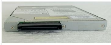

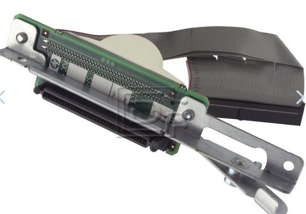

Im ordering the LSI HBA in IT mode now. After looking at my cd/dvd optical drive for some time I cant find an adapter for an SSD. Suggestions??
