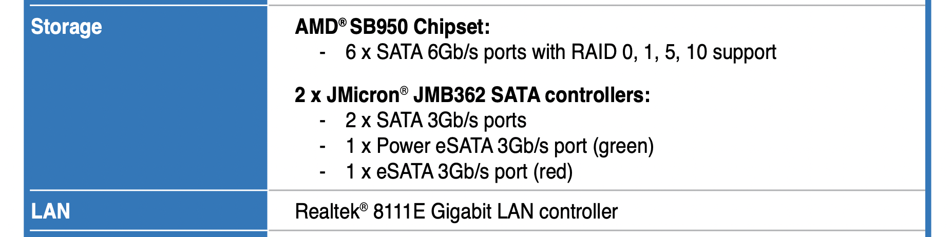

Jun 2, 2019
590
Assuming it's a R0, might have trouble with the onboard RAID controller and Realtek NIC, so be prepared to install a HBA controller and Intel NIC. Still might be worth kicking the tires with TrueNAS CORE or SCALE.

Well, there are refs on the web with users saying FX 8320e + ECC on Sabertooth 990FX R2.0 works. The ASUS R2.0 manual say it supports unbuffered ECC RAM and the BIOS has entry to enable ECC mode. I still have a ASUS M5A78L-M/USB3 AM3+ board that has the same BIOS ECC mode setting and definitely worked with and fully supported ECC memory as shown in the demidecode when running linux. I'd certainly prefer to have ECC memory than not.
My concern is the added Jmicon or ASmedia chip for those extra two SATA ports. Not sure they'd be supported or would trust those when running TrueNAS.

From the FreeBSD Hardware Compatibility List:
"The ahci(4) driver supports AHCI compatible controllers having PCI class 1 (mass storage), subclass 6 (SATA) and programming interface 1 (AHCI).
Also, in cooperation with atamarvell and atajmicron drivers of ata(4), it supports AHCI part of legacy-PATA + AHCI-SATA combined controllers, such as JMicron JMB36x and Marvell 88SE61xx.
and
"The re(4) driver supports RealTek RTL8139C+, RTL8169, RTL816xS, RTL811xS, RTL8168, RTL810xE and RTL8111 based Fast Ethernet and Gigabit Ethernet adapters including:"
So the SATA and NIC will probably be ok as long as their isn't anything else on the MOBO that isn't supported. I would try it with a USB stick for testing (I wouldn't use a USB stick for production). The big issue is the ECC ram support. I personally wouldn't run a NAS without it, but honestly almost every "canned" NAS consumer appliance out there doesn't use ECC ram anyway. This is the reason I swapped to FreeNAS/TrueNAS from a Netgear appliance.
