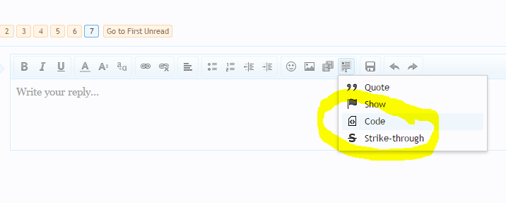

Bidule0hm
Server Electronics Sorcerer
Aug 5, 2013
3,710
Actually it's not broken to this point but just a bit. It's just that the OP doesn't used the code tag.
qwertymodo
Apr 7, 2014
144
Huh, they must've fixed it. Last time I tried the code tag it didn't use a monospace font and it seriously screwed up whitespace.

depasseg
FreeNAS Replicant
Sep 16, 2014
2,874
Code tags relate to the reply in the thread. It makes it easier for us to read the results you paste.
