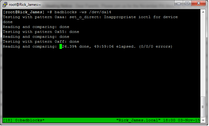

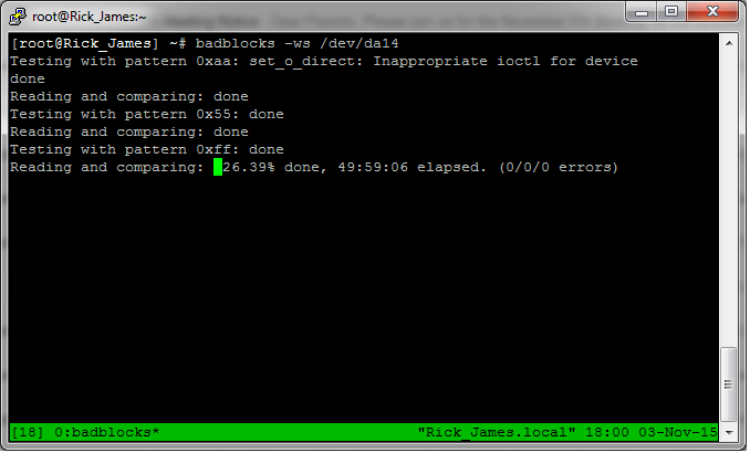

So badblocks has been running for over 2 days now... looks like it is running the same test over and over. Is that right? Can I say that this ran ok and I should stop it now?
It's normal. It's testing different patterns.
How many patterns will it go through?
EDIT: Found the wiki on badblocks. Looks like default goes through 4 patterns. I am on pattern 3/4 so I probably have another 36 hours left.
badblocks wiki said:
read-write Test (warning:destructive)
This test is primarily for testing new drives and is a read-write test. As the pattern is written to every accessible block the device effectively gets wiped. Default is an extensive test with four passes using four different patterns: 0xaa (10101010), 0x55 (01010101), 0xff (11111111) and 0x00 (00000000). For some devices this will take a couple of days to complete.
