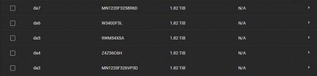

I have 2 Pools Data01 and Data02, all of my hard drive in the Pools Data02 change for Data01. Result of this mismacth the Pools Data02 is OFFLINE. How to respecify the good Pools with the good hard drive?

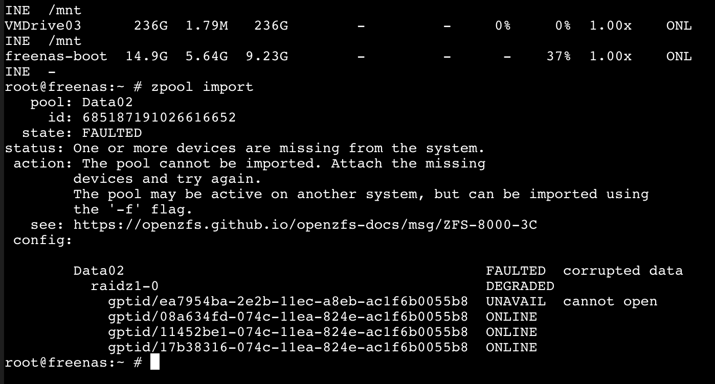

Can you provide more information? Do you mean you took the data2 drives and created a new Data01 pool with them? Some output of the
zpool list
or
zpool import

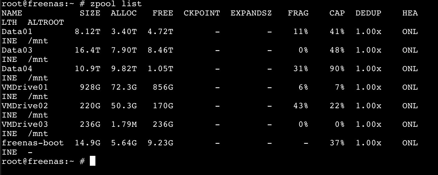

Correction: I have Pools:
1- Data01 Pool
2- Data02 Pool
3- Data03 Pool
4- Data04 Pool
5- VMDrive01 Pool
6- VMDrive02 Pool
7- VMDrive03 Pool

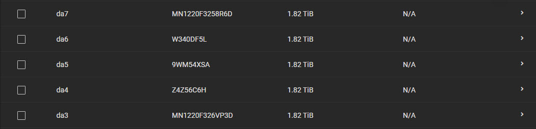

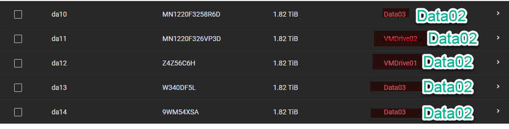

After reboot all of my hard driver in Data02 change to Data03 and the Pool Data02 is OFFLINE.

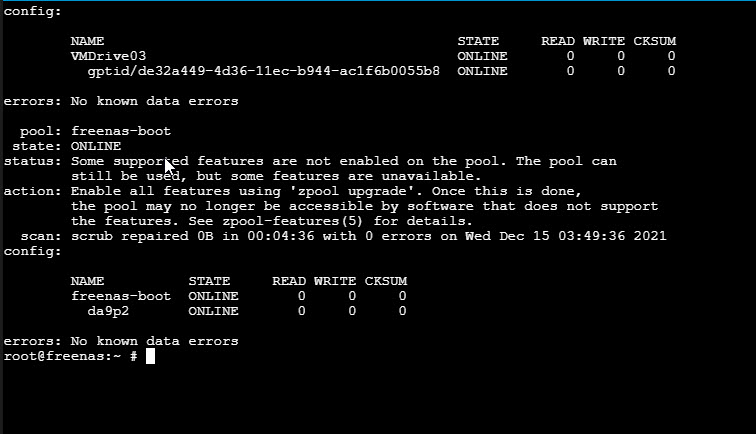

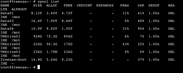

I make the zpool import and zpool list in Attach file.
Tell me if you need more informations.

If you run "zpool status" do you see that "UNAVAIL" gptid/ea7954ba-* in use on any of your other pools? Do you know if the disk is offline or missing for a reason?
You can try "zpool import -f Data02" to force it to come back, but only if you know for sure those disks aren't in use on another pool elsewhere at the time.

All the disk is online but configure with the bad Pool Data03, VMDrive02 and VMDrive01 check my picture . I try zpool status and zpool import -f Data02 i add attach file.

Hard to tell what is happening from the information provided. What is interesting, is you are telling us that your Data02 pool was 5 disks originally, but ZFS only reports it as four, with one of them being offline.. Did you remove a drive by mistake? Is the data from Data02 backed up?

9,700
You could tell me if I can match again the disks with the pool Data02?
It's very doubtful that you will be able to recover from the current situation based on what you're telling us.
If the disks that made up your pool are now members of other pools, the critical information on those disks will most likely be overwritten with the current pool membership.
Your only other alternative will be to use a recovery tool like Klennet (https://www.klennet.com/zfs-recovery/default.aspx)... not free and requires a windows machine to be attached to either the original disks or disk image files. You will be able to see if it can find your data before you have to pay, so if it's important data for you, it may be time well spent to investigate.
