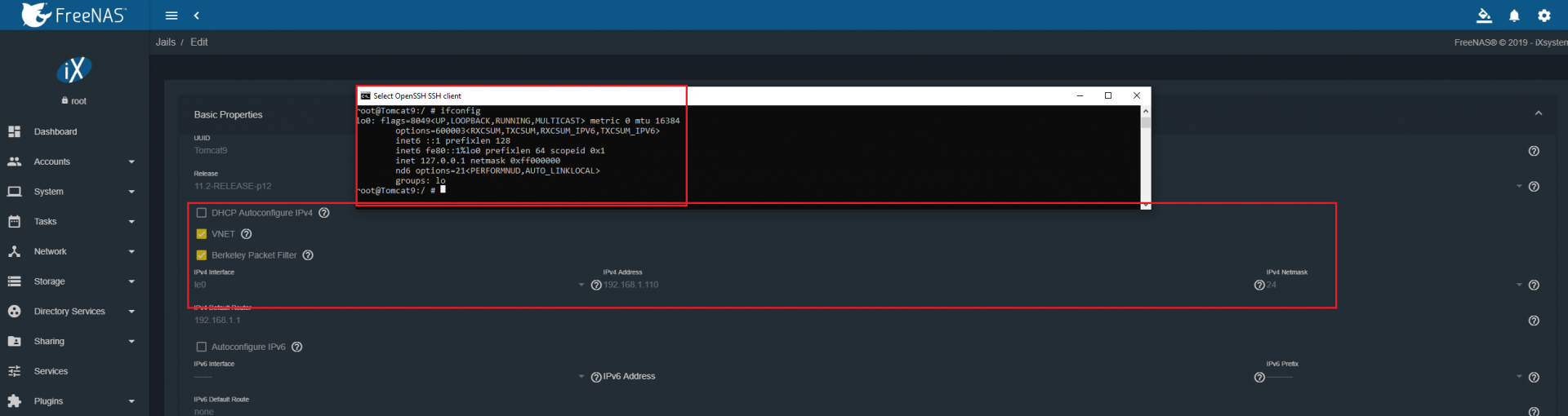

However I have a problem, I try to setup the network interface. I don't want to be DHCP and I hope to make it static IP.
My Freenas ip is 192.168.1.109, and I hope to make the tomcat to be 192.168.1.110.

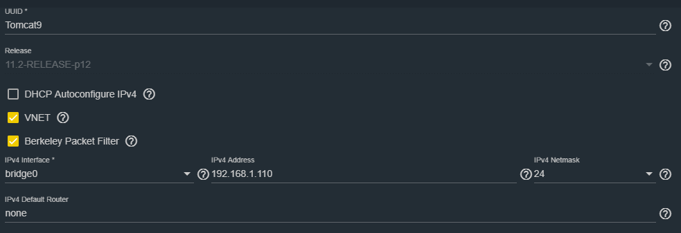

I try to setup several parameters in the jail GUI as an enclosed picture:
VNET / Berkeley Packet Filter checkbox is checked.
IPv4 Interface = le0
IPv4 Address = 192.168.1.110
IPv4 Netmask = 24
IPv4 default Router = none
But I cannot make it work... I research on the internet for a day and no luck, any hints?
In addition, is it possible to use the same IP address (e.g. 192.168.1.109:8080) to connect to the tomcat? Any help would be appreciated, thank you very much.

9,700
You will need to set the default router to something or your jail won't get out of your network.
The screenshot seems to show you selected the bridge as the interface... this is normally set to em0 or igb0 (depends on your NIC driver).
Otherwise, your settings look OK.
I recommend avoiding the sharing of the FreeNAS GUI IP (you would need to not use VNET in that case) as it can cause problems that are difficult to diagnose.

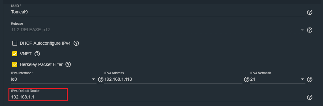

I set the default router to either 192.168.1.1 (My physical router IP address) or 192.168.1.109 (Freenas IP address), I still cannot connect.
If I uncheck the VNET, the "IPv4 Default Router" field gray out, and I even cannot start the Jail.
May I know anything I miss? Thanks for your help.
akumanova68
Aug 5, 2019
12
For Sretella,
I also enclosed the setting for your reference, thank you very much.
9,700
Under Jaill properties, check the option for allow_raw_sockets
If it still isn't working, post the putput from CLI on the host and in the jail from ifconfig
akumanova68
Aug 5, 2019
12
Hi Sretalla,

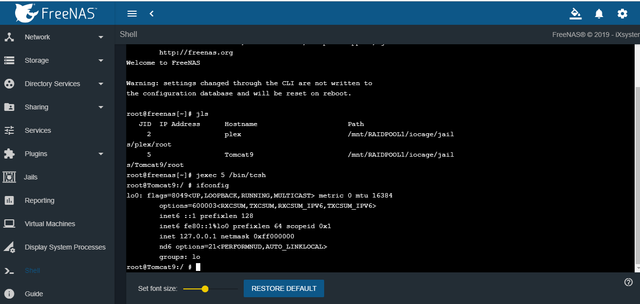

Thank you for your suggestion. I also tried the "allow_raw_sockets" property but no luck. I run the ifconfig command under the jail and enclosed, any hints? Thanks.
9,700

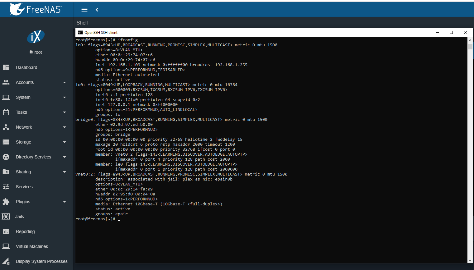

It's clear you are missing the epair in the jail. What about ifconfig on the host?

Thanks for your reply. I have no idea what the epair is. I also enclosed the ifconfig for the host, any hints? Thanks.

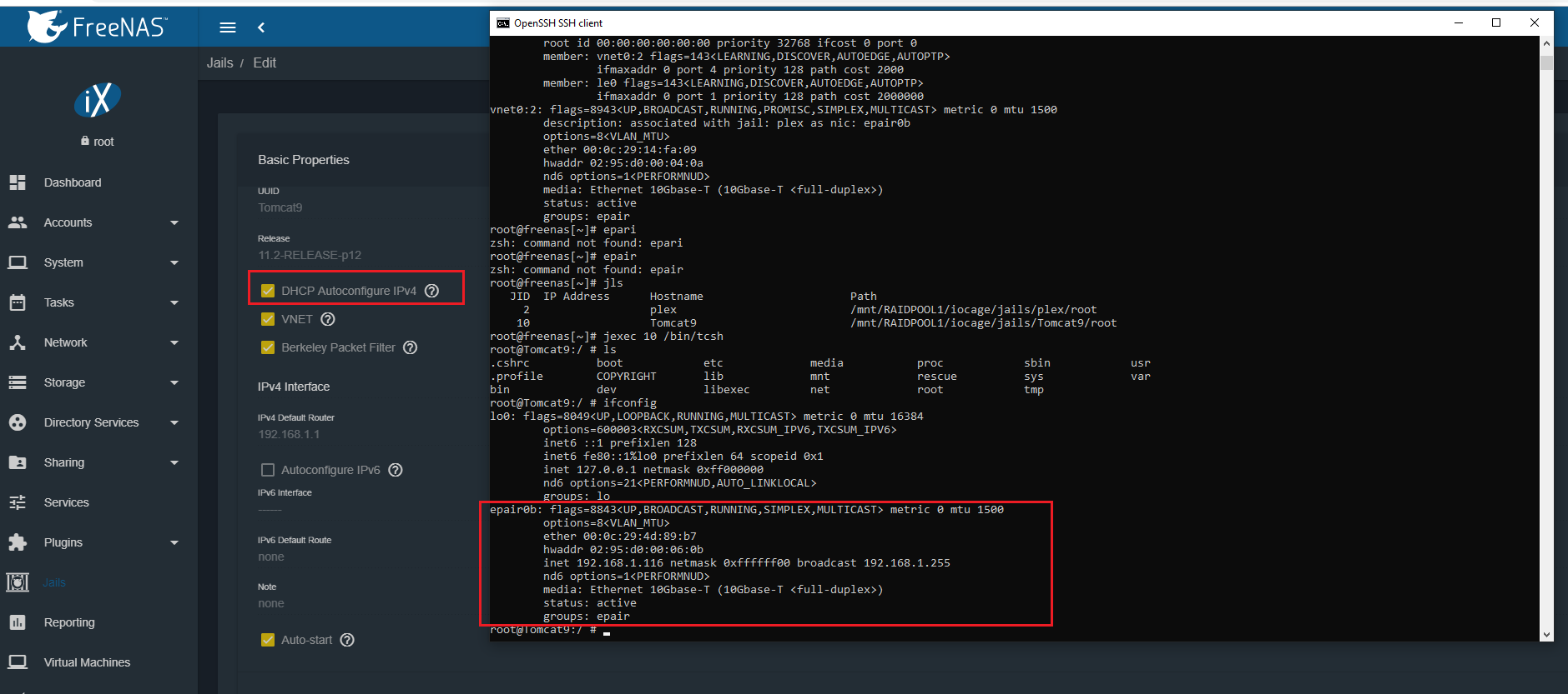

I also attach another two version of ifconfig.
Cap1.png shows the workable solution, which is using the DHCP. It contains epair interface
Cap2.png and Cap3.png shows the problematic settings, which is not using DHCP. It really does not contain the "epair" interface.
I have no idea is this "epair" interface is created by FreeBSD jail itself? Please advise and thanks.

The jail system creates the epair (when things are working properly).
I recall reading about some problem with static IPs and jails. Which exact version of 11.2 are you running?
Perhaps the best solution for now is to statically reserve an IP for your jail in DHCP. (that's how I've always done mine)

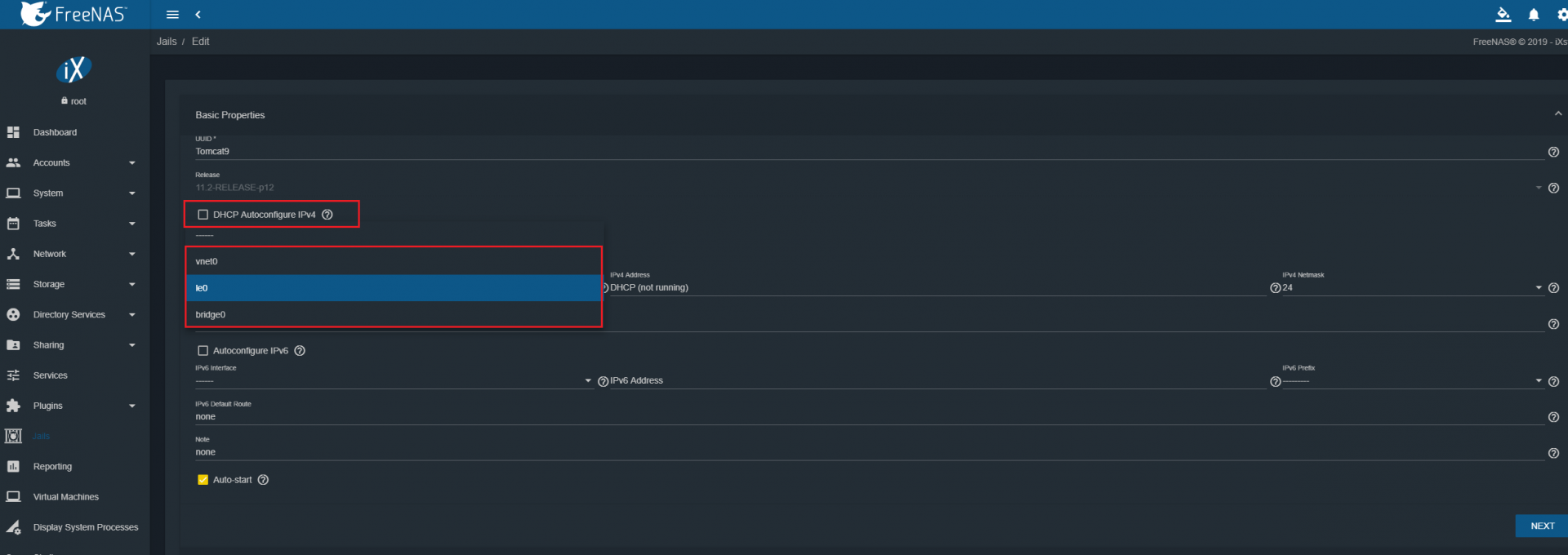

One more thing to try is using vnet0 as the interface instead of le0.

Thank you for your reply. I also try all possible choices such as vnet / bridge but no luck. I've already tried all possible configuration and I give up now.
