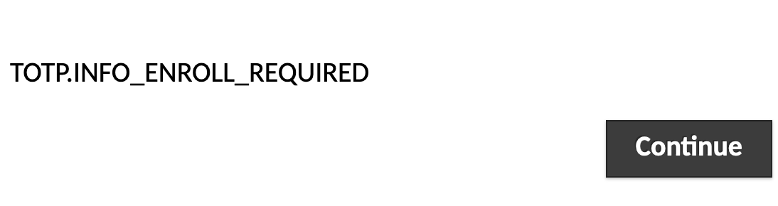

First I then tried a restart of tomcat (not putting the command since it proved to be no good).
On login I got:
No way forward from that...

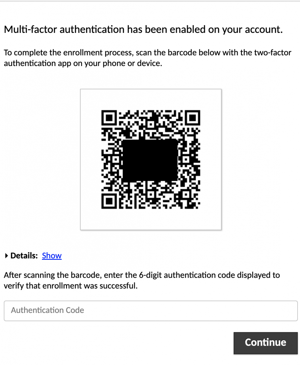

So I restarted the jail (from the host: iocage restart guac)
and then:
As far as I can see, done deal.
