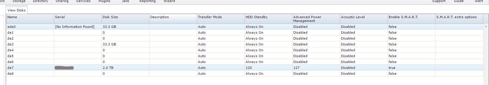

My setup is Windows 2012 R2 physical machine with hyper-v running a Gen 1 VM with freenas 9.10.1-U2
I have 1 VHD for the freenas boot drive, a 32GB VHD and a 2TB physical drive directly attached to the VM
From the attached image ada0 is the 32GB VHD and 2TB is da7
When navigating to Storage -> View Disks I find that there are multiple 'ghost' entries in the list of disks.
They don't exist in the system and generally the disk size comes up as 0 however there does seem to be ghost entries of real disks too.
I think new entries are added sometimes when I boot up the system so using the method described here to remove the entries from freenas may not be a solution.
What do you guys suggest doing? Is this a bug in the system?

Sounds like Hyper-V being Hyper-V. A pisspoor VM solution. I run 18 Hyper-V hosts at work and I hate them.

We experienced this when we were messing around with FreeNAS on Hyper-V. It usually occurred when FreeNAS was rebooted and FreeNAS assigned new labels to the drives. Hyper-V thought the other labels were drives but they didn't really exist.
Hyper-V is a really terrible solution for FreeNAS. Of all the hypervisors we messed around with, it was the one that caused the most issues, including wrecking a data set.
I'd stay far away from Hyper-V if I were you.

I know this is a bit old now but I have just come across a Microsoft article relating to this issue and I wondered if we can implement this on FreeNAS?
https://docs.microsoft.com/en-us/wi...best-practices-for-running-freebsd-on-hyper-v
It basically says you can create labels (using glabel) for each drive partition so that the old devices are not orphaned and new ones created.
I have not been able to update to any newer version of FreeNAS since 9.10.1-U1 as I get a mountroot error every time I boot to any other version. If this gets around the mountroot error then I will be very happy!
