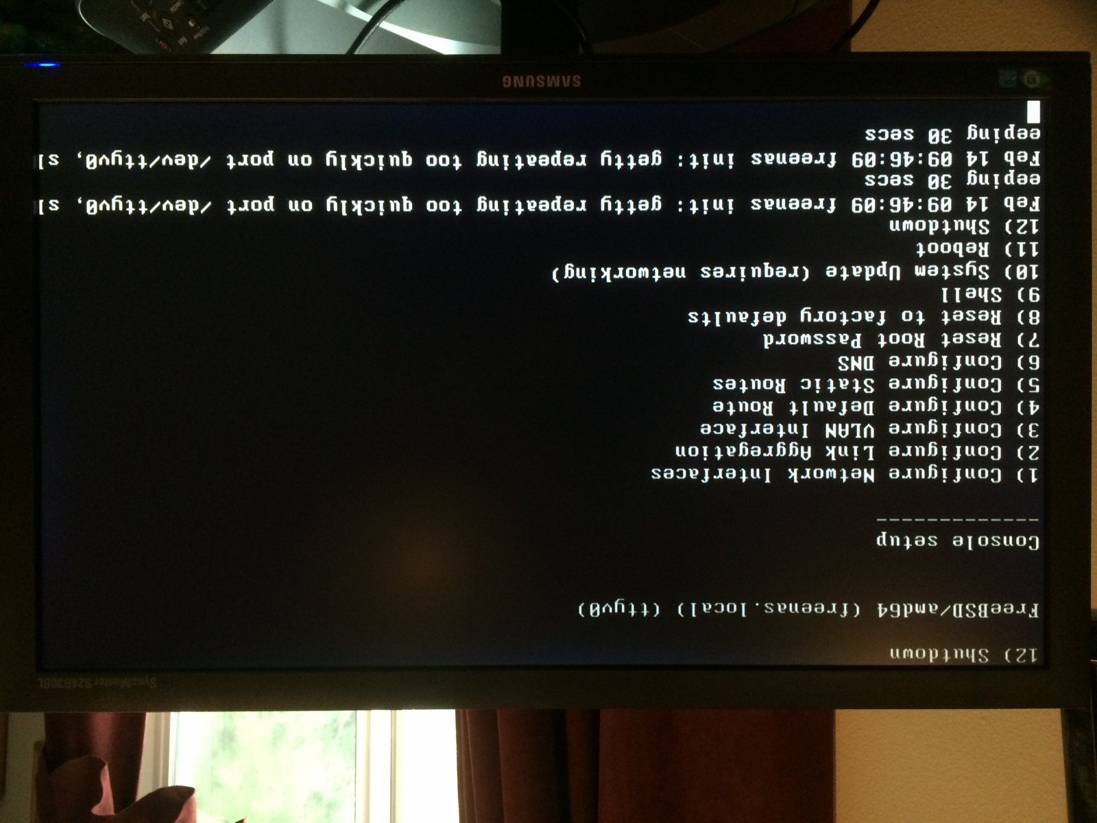

I am having a similar issue and receiving the same error. I should add that while I am a newbie to FreeNAS I did take the time to read Cyberjock's noob guide as well as the manuals and more forum posts than I want to think about before I got started. I should also add that I know my configuration is not ideal for freeNAS (e.g. no ECC ram) but it was bought for a hackintosh build that turned into a fiasco (long story not relevant here). Short version: I went to a freeNAS build based on a friend's recommendation as a plan B. After about 100 hours and several weekends I had a stable build working until the power went out yesterday. It is hooked up to a UPS but it must have been too long for the battery as both this and the old server it is replacing (MS Home Server) were both off when I got home.
Basic configuration:
MSI Z87-GD65 MOBO
Intel Pentium G3450 Haswell Dual-Core 3.4GHz LGA 1150 53W Desktop Processor Intel HD Graphics BX80646G3450
Seagate Barracuda 3TB HDD (x4)
Crucial Ballistix Sport XT 8GB (2 x 4GB) 240-Pin DDR3 SDRAM DDR3 1600 (PC3 12800)
freeNAS 9.3 running on 16GB Toshiba Flash Drive set up as ZFS2
Plugins so far: OwnCloud, Couch Potato, PLEX (I only used OwnCloud to date)
Problem: When I reboot the machine I get what is shown in the attached image file. I cannot get in through the GUI nor can I get to the shell. In fact, I can't get to any of the 12 menu options shown. I can do a CTRL-ALT-DEL to reboot which is unhelpful.
The good news: I may be a newb at freeNAS but I have been using computers for a long time and trust them not at all. I loaded a lot of data onto this server but nothing I don't have backed up elsewhere. If I need to start over, I lose nothing but time and the CO2 it will require to expel curse words.
My ask: Any help would be appreciated. Please consider my knowledge level in your response. I cannot recode Python scripts without detailed guidance (or any other such esoteric actions) but I can use a command line (if I can get to it somehow).
Thanks in advance!
