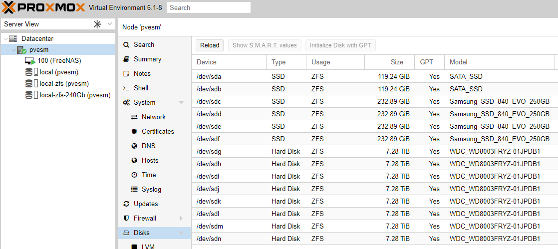

LSI SAS9300-8i 9300-8i 12G SAS3 S-ATA HBA (8x 8TB SATA HDD, 4x 240GB SSD connected to it)

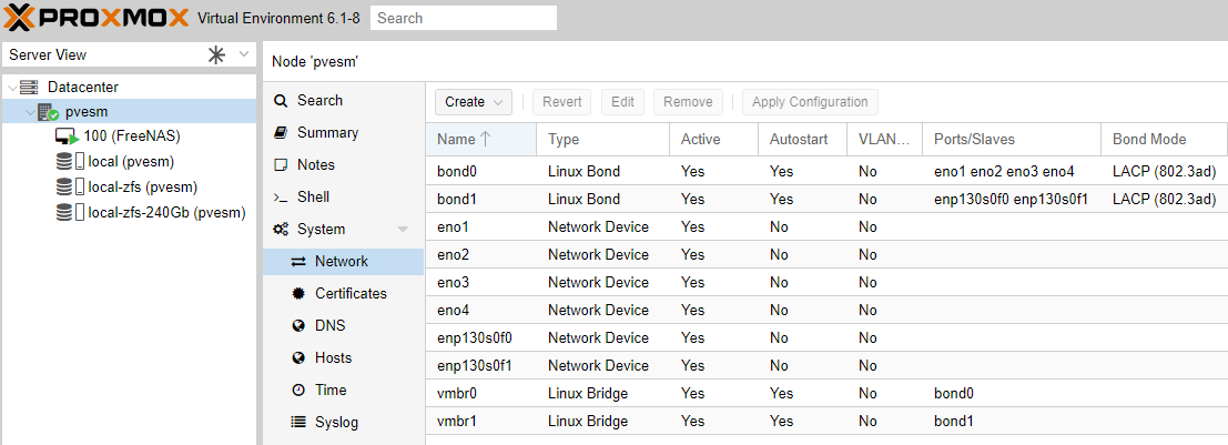

4x 1GbE NICs - bonded in proxmox - my LAN
1x dual port 10GbE SFP+ NIC - bonded in proxmox - my dedicated SAN

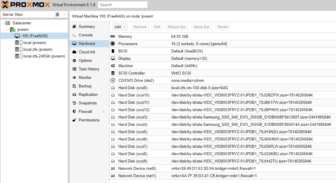

My FreeNAS VM configuration (64GB RAM, 8x 8TB SATA HDD - RAIDz2 with 1x SSD for cache and 1x SSD for log, which gives my aprox 40TB RAW space)
I have already tested couple of different configurations. When I did pass-through my entire LSI controller with all the disks attached to it directly to FreeNAS, had some problems with FreeNAS drivers for this type of LSI controller. Decided to pass-through selected drives to FreeNAS VM (see attached file). This way everything works fine, FreeNAS sees all drives perfectly, and I think I'm more flexible in case I want to migrate my FreeNAS VM to a different bare metal server in the future. Do you think with such configuration, I can still have problems you mentioned by jgreco? Or I'm ok?

@KasprowiczM17
I really wish that i had an answer for you... All your Proxmox configs look standard for disk passthrough... the only issue i see is that even through in theory you are "cutting" out proxmox to these drives they are still being managed by the hypervisor and the FreeNAS VM will not have direct access to them in a raw format. I am interested in the outcome of this but i would imagine that it will work properly for quite some time until it doesnt... One test you could try is to write fake data to this pool... export the pool... and try to import on either a new VM (not recommended) or a physical FreeNAS host. I would imagine that would tell you the level of control that FreeNAS had over the raw disk.
