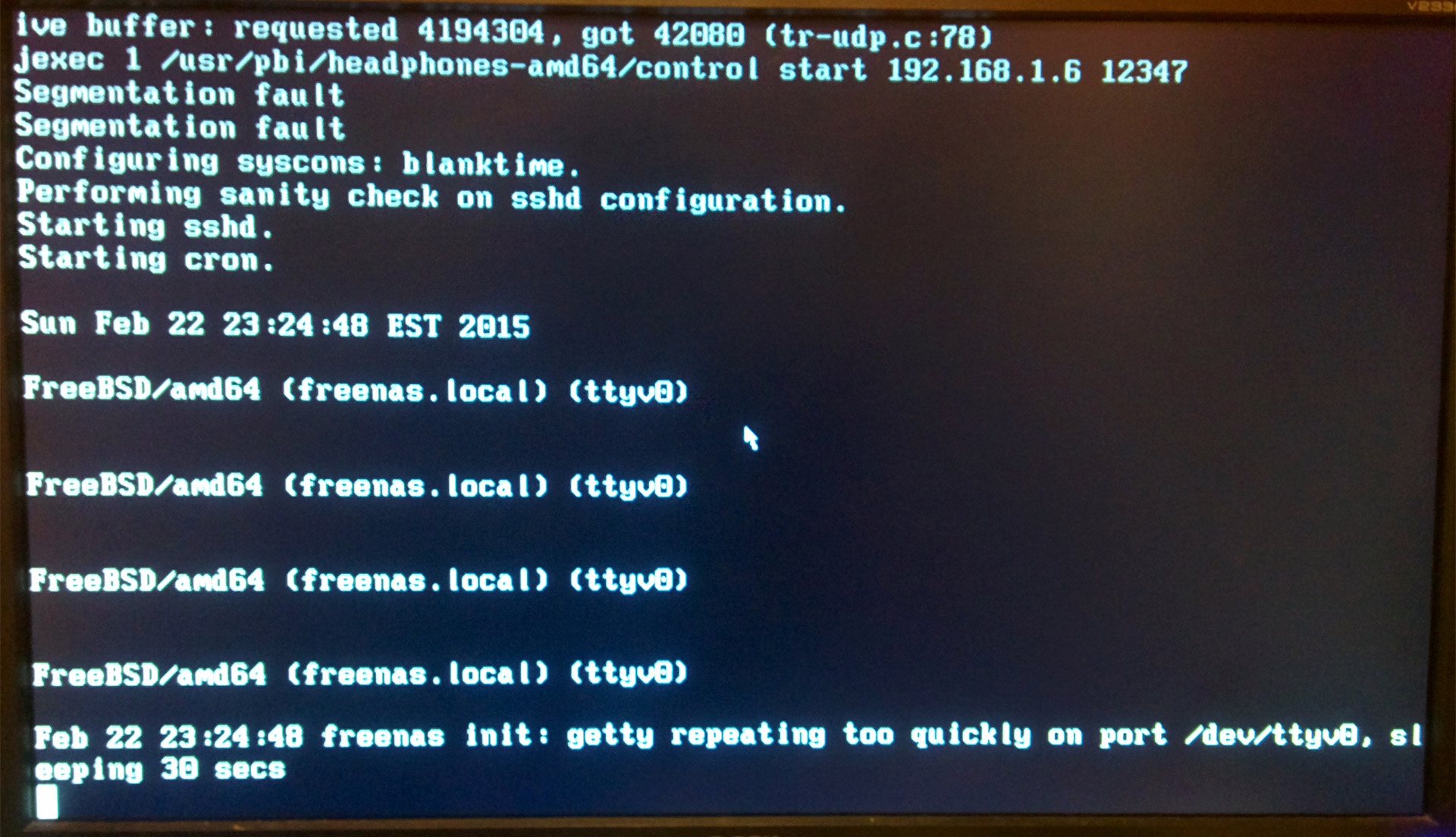

I have experienced a problem with my freenas setup. I restarted freenas using the webui, but freenas never properly booted back up again.
Attached is an image of what freenas shows me. I am unable to access the web ui or any of my shares.

Which version of FreeNAS? If 9.3, which boot entry did you boot into (it will show in System -> Boot as active).
DrKK
FreeNAS Generalissimo
Oct 15, 2013
3,630
Well, a number of things could cause this problem. To start with:
* Try your keyboard or any other human interface device in different USB ports.
* Check for possible corruption of the system files (verify install)
* Check for corruption of the /etc/gettytab file
If this were me, I'd suspect that your boot device, with the system files, has become corrupt.

Ive tried different keyboard and usb port, no luck
How do i verify the install for freenas? Should i try and upgrade to freenas 9.3 to try and rectify my problem?

The install verify is a 9.3 feature.
I thikn all the signs are pointing towards you:
1) Backing up your config
2) Getting the .iso for the latest FreeNAS
3) Installing fresh, from that
4) Then, uploading your config file.
