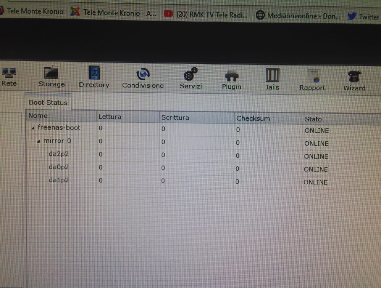

Hi, I have a freenas 9.10.2-U1 system with the operating system in 3D mirrors by three USB sticks (I enclose photos). I realized that removing a USB stick in particular I do not like the system and I compare this saying: "this is a datadisk nas and can not boot the system.
I tried a discounted rate from my second pen, but I always compare the same warning.
I do not understand why, since the two pens are the mirror of the other pen, does not the freenas operating system start?
My fear is that breaking this stick will not be able to start the system.
Obviously I saved the configuration file
By putting the aforementioned pen back on, the system starts normal.
Anyone can tell me why with the other two pennies (mirror copies "mirroring") can not start the system?
help me please!!!

My guess is that the boot sector is not mirrored but the volume is. redundancy in the boot drive is more about preventing a total crash of a running system. Not saving the ability to boot. Most servers do not boot often.
USB may be a whole different story and dependent on the system board support for USB booting, but I have tested my system with SATA boot drives and it can boot from either drive.
Most likely, you need to select the specific USB stick to boot from in the BIOS. It probably only supports a single boot device and to switch requires manual intervention.

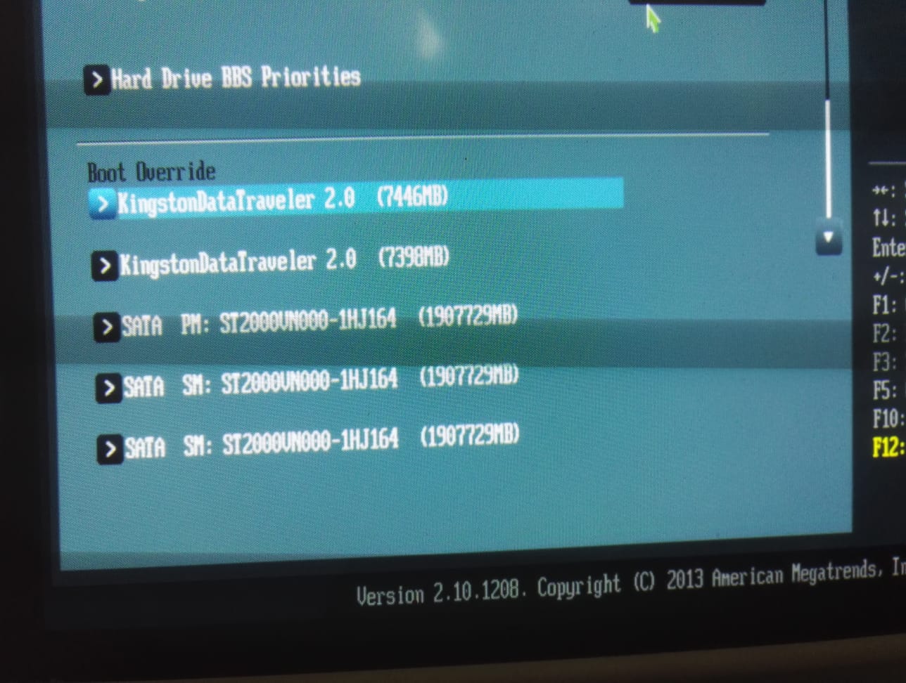

Prax
Dec 17, 2018
5
Chris Moore
May 2, 2015
10,079
You should take the data drives out of the list of potential boot drives in the BIOS.
