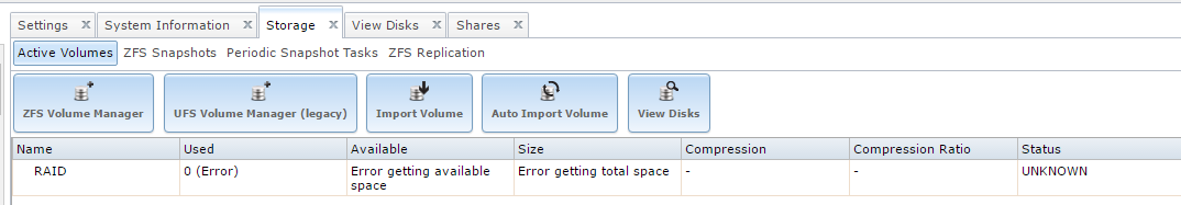

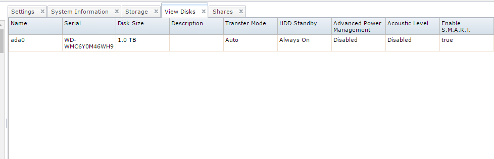

Thank you gpsguy. I've read through the replace disk steps in the documentation. I could not remove or replace disk because Freenas does not reach the point where the GUI is loaded. So I removed the disk physically that is causing the issues and with the one old disk and the new one it's booting completely and I can access the GUI. But in the GUI it's not showing any other disks apart from the new one even though it's detected in the bois. In view active volumes it's showing the Raid volume that used to be there, as far as I can remember. I've included some screenshots, one of the active volumes, one showing the disk and one with the system config.
