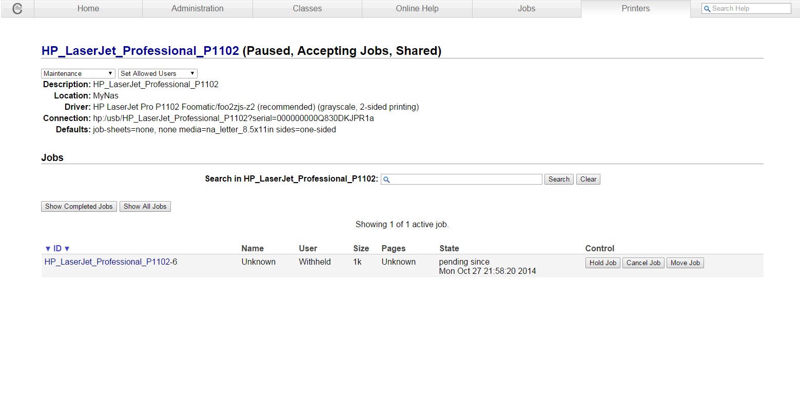

frankwang.au
Aug 25, 2014
Thanks Robert.
I have done that and CUPS is up and running, I can submit jobs but nothing happening.
Printer status: Paused
Any ideas?
Robert Smith
May 4, 2014
270
Are you trying to print from a Mac? I get something similar when somebody with a Mac tries to use the print server.
Works fine from Windows clients.
May have something to do with a print job having to traverse two CUPS servers...
