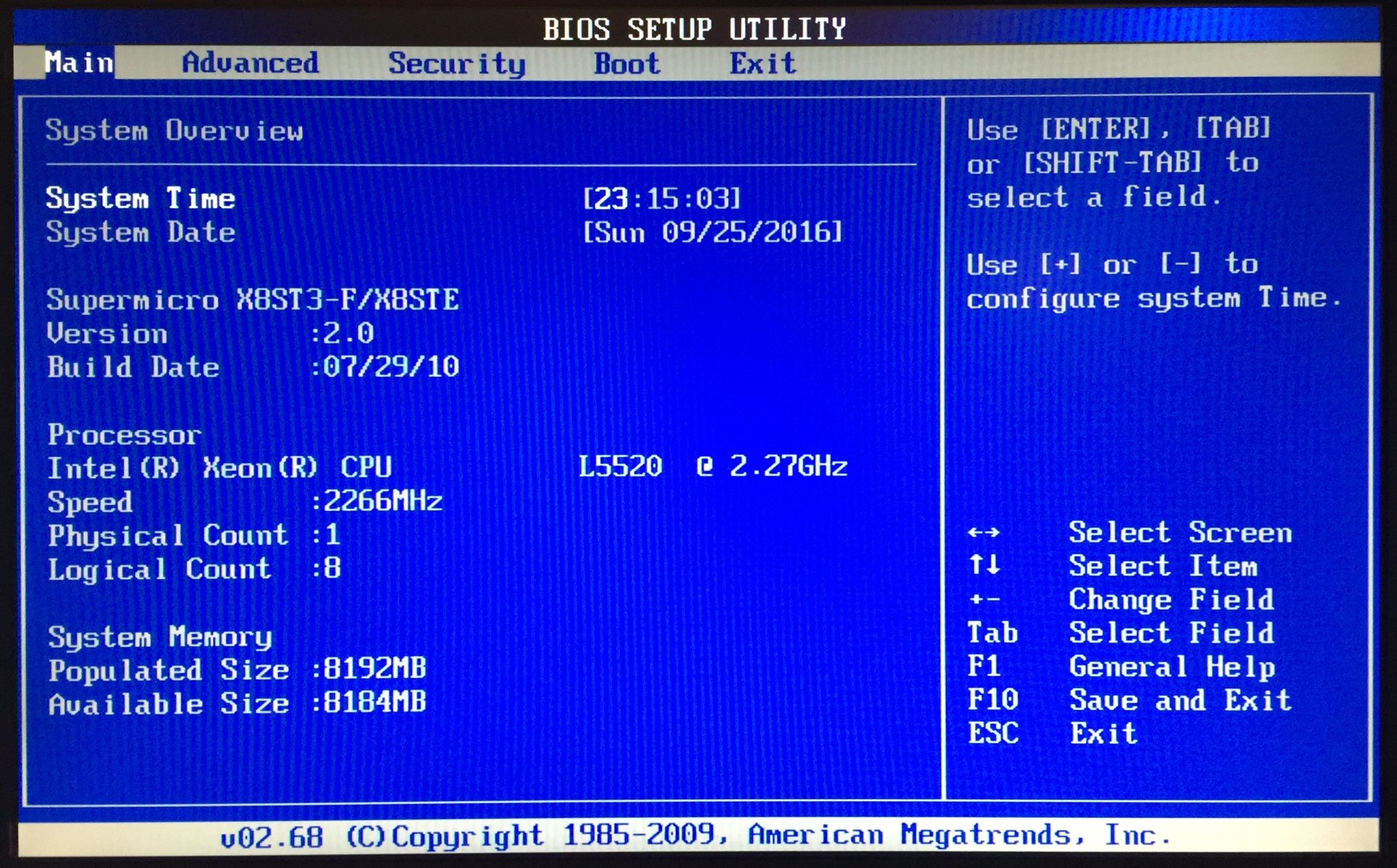

After years of buying external HD's, one after another, I have ventured into the Big Boys world and decided to build a NAS for my storage purposes.
Enclosed is a picture of my hardware so far, I will be adding more RAM soon but its what came with the motherboard.... Additionally I have 5x4TB WD Enterprise drives.
Everything is up and running however the issue I have run into is when I am trying to set the volume in Raid 5(?), my 4TB drives only show up as 2.2TB.

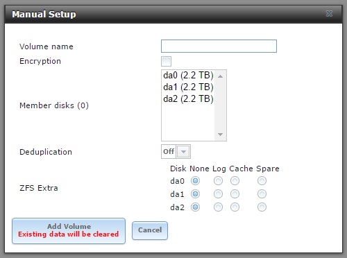

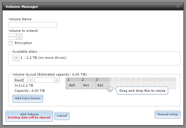

Thanks for the reply....
Here are 2 screenshots of where its showing the drives as 2.2TB.
Right now I only have 3 drives installed but they all show the same when installed.

I'm going to guess the hba you're using doesn't support over 2tb drives
Stux
Jun 2, 2016
4,419
Are you using the motherboard Sata connectors?
2.2TiB is a classic limitation in earlier gen sas/Sata equipment.

Hardware spec and freenas version are required for all questions, please provide that information. I bet you are using a sas1 controller and that is what is limiting you to 2.2TB disk sizes.

Well, there's my first mistake and I'm sure more to come but thanks to those who pointed out I used the wrong ports, I did not realize there was a difference.... I do now.
All 4TB are now showing up.
