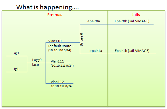

I am pulling my hair out trying to resolve this. can some Freenas Networking experts please help ?
I plan to create multiple jails in my Freenas box and plan to run these jails in different subnets. However there isnt any easy to follow "How to" that I could find. The problem seems to be that the epairXb interfaces used by the (VIMAGE) jails seems to be attached the default route which is on it own VLAN. There by breaking the vlan setup of all the jails as they need to be on different vlans. I have attached a picture of what is happening now.
What I want to be able to do is have the jails assigned to vlan112 or vlan111. The freenas box itself needs to be on vlan110. Is this possible in Freenas 9.3.1? Any pointers will be well recieved.
jkmuk
Mar 11, 2015
24
in the picture 'ig0' and 'ig1' are the only two physical NICs . They are teamed (link aggregation using LACP) as 'lagg0' from that point forward everything is a virtual interface.

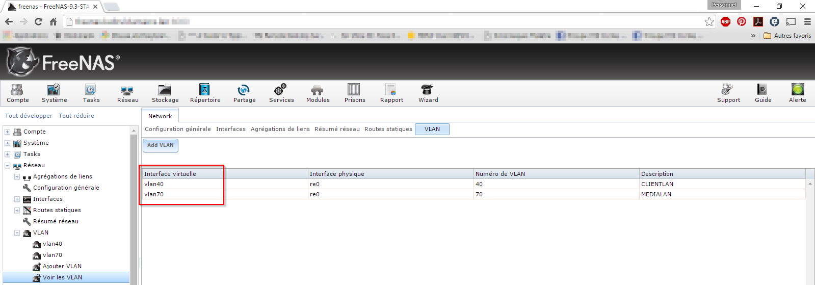

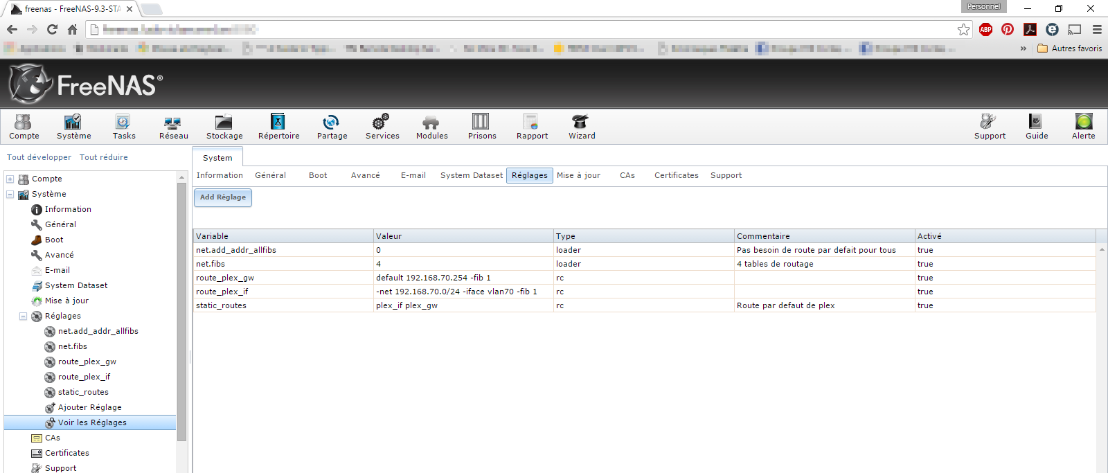

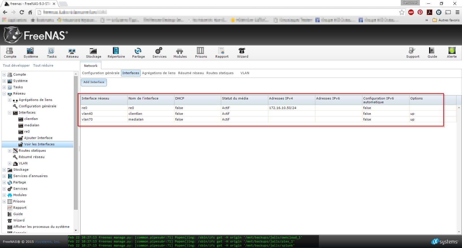

I achieved what you are describing by following these steps:
1- Create VLAN interface
2- Define tunables in loader
3- Define routes in rc (in seperate route table with fibs)

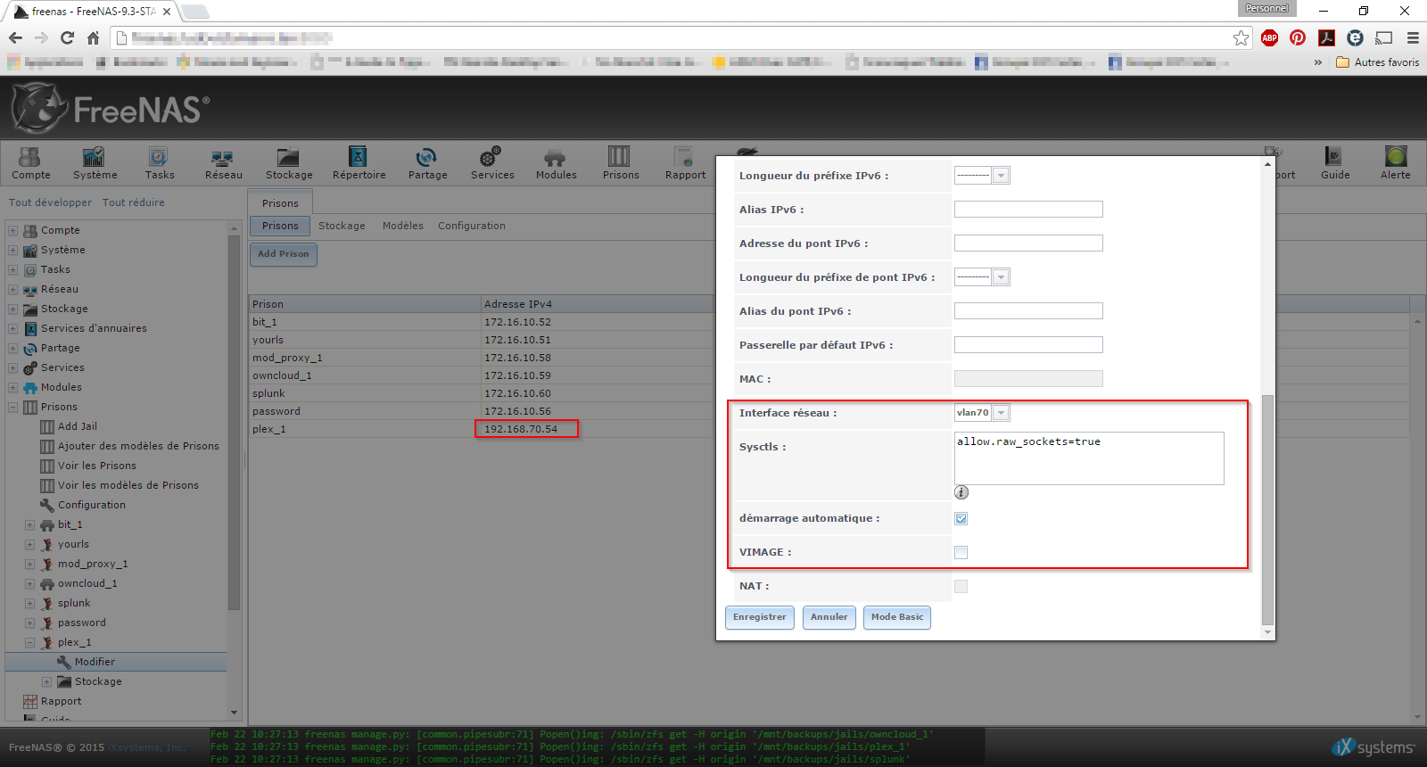

4- Apply route fib to your jail permanently: echo "/usr/sbin/setfib 1 /bin/sh /etc/rc" > /mnt/backups/jails/.plex_1.meta/jail-start
5- Reboot
You can use these commands to debug as root in freenas host:
sysctl net.fibs
sysctl net.add_addr_allfibs
ifconfig vlan40
ifconfig vlan70
setfib 1 netstat -rn
setfib 1 jexec 7 /bin/tcsh
Or from within the jail:
netstat -rn
Note:
If you use the webgui and open the terminal from there you will not get the correct route table in the jail. You should enable ssh server inside the jail and log in to it that way instead.
In these commands I used my vlan tags, internal IP addressing and jail number. You should of course substitute with your own.
Sources:

Yes. As you can see from the screenshots I just attached, most of the configs are made through the GUI. The only config made outside of GUI is step number 4 which is a command written inside your jails dataset on a physical hard drive.

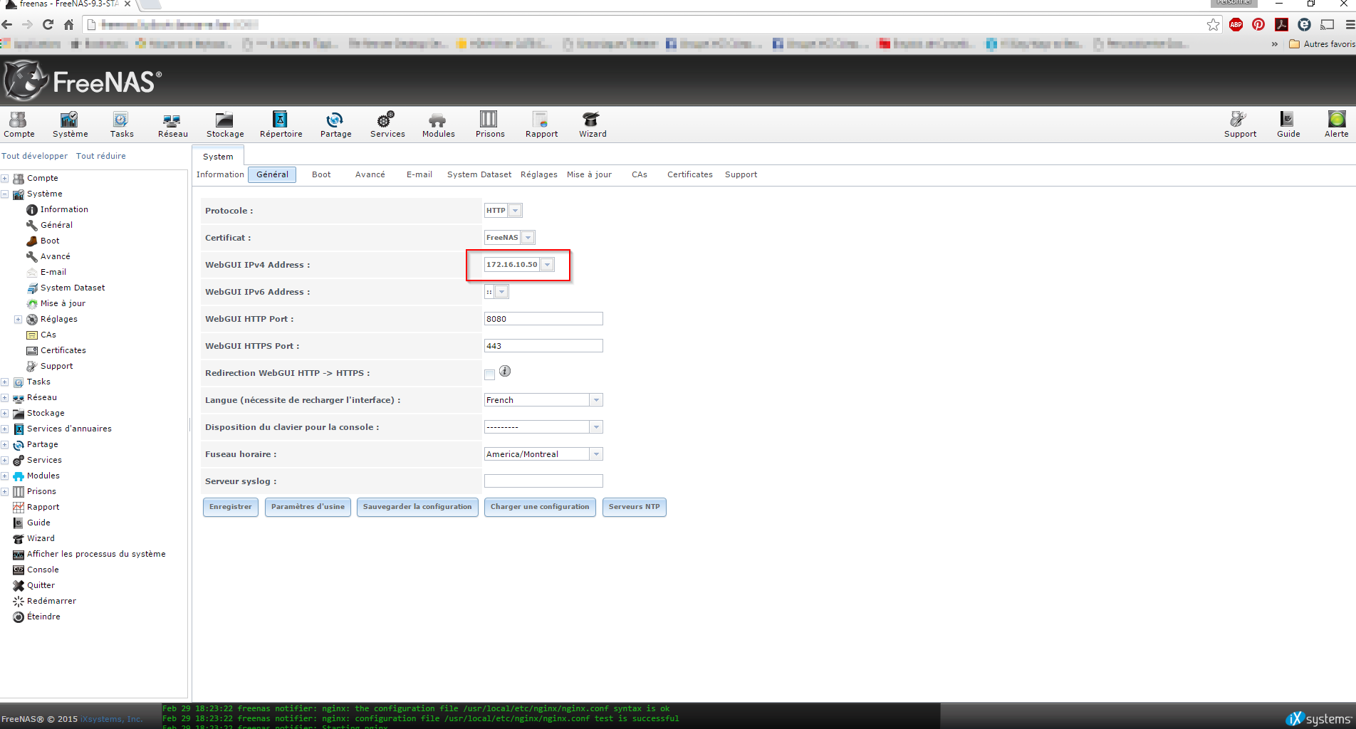

Also you should make sure you are not making your system vulnerable by exposing it on an unsecure subnet.
You should bind your webgui to only your management subnet IP because otherwise people will be able to connect to your freenas through all your subnets.
You should also note that the rest of your services directly provided by the base OS (FreeNAS) may be accessible through your additional IPs (assigned to each individual jail). SSH, FTP, CIFS, etc.
